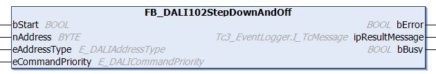

FB_DALI102StepDownAndOff
FB_DALI102StepDownAndOff 1:
The output value of the DALI control gear is reduced by one step.
If the output of the DALI control gear is already at the minLevel value, it is switched off.
FB_DALI102StepDownAndOff 2: Inputs
  bStart            : BOOL;
  nAddress          : BYTE;
Type
bStart
nAddress
BYTE
eAddressType
E_DALIAddressType
eCommandPriority
E_DALICommandPriority
FB_DALI102StepDownAndOff 3:
FB_DALI102StepDownAndOff 4: Outputs
Type
ipResultMessage
I_TcMessage
bBusy
FB_DALI102StepDownAndOff 5: Properties
Type
Access
Initial value
ipDALICommunication
I_DALICommunication
Get, Set
NULL
