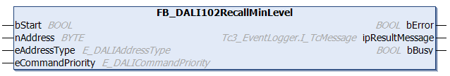

FB_DALI102RecallMinLevel
The output value of the DALI control gear is set to minLevel value.
If the DALI control gear is switched off, this command switches it on.
Inputs
bStart : BOOL;
nAddress : BYTE;
Outputs
bError : BOOL;
bBusy : BOOL;
bBusy | BOOL | The output is set as soon as execution of the DALI commands has commenced. It remains active until all DALI commands have been processed. For some errors (e.g. faulty parameters), bError is set immediately after the positive edge at bStart without bBusy switching to TRUE. |
