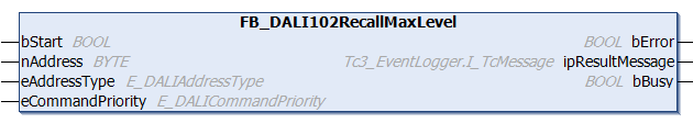

FB_DALI102RecallMaxLevel
FB_DALI102RecallMaxLevel 1:
The output value of the DALI control gear is set to maxLevel.
If the DALI control gear is switched off, this command switches it on.
FB_DALI102RecallMaxLevel 2: Inputs
  bStart            : BOOL;
  nAddress          : BYTE;
Type
bStart
nAddress
BYTE
eAddressType
E_DALIAddressType
eCommandPriority
E_DALICommandPriority
FB_DALI102RecallMaxLevel 3:
FB_DALI102RecallMaxLevel 4: Outputs
Type
ipResultMessage
I_TcMessage
bBusy
FB_DALI102RecallMaxLevel 5: Properties
Type
Access
Initial value
ipDALICommunication
I_DALICommunication
Get, Set
NULL
Requirements
Development environment
required PLC library
TwinCAT from v3.1.4022.29
Tc3_DALI from v3.1.4.0
