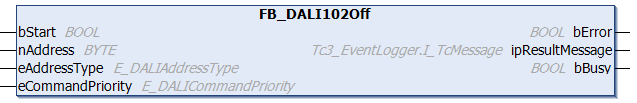

FB_DALI102Off
FB_DALI102Off 1:
The DALI control gear is switched off immediately.
FB_DALI102Off 2: Inputs
  bStart            : BOOL;
  nAddress          : BYTE;
Type
bStart
nAddress
BYTE
eAddressType
E_DALIAddressType
eCommandPriority
E_DALICommandPriority
FB_DALI102Off 3:
FB_DALI102Off 4: Outputs
Type
ipResultMessage
I_TcMessage
bBusy
FB_DALI102Off 5: Properties
Type
Access
Initial value
ipDALICommunication
I_DALICommunication
Get, Set
NULL
