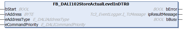

FB_DALI102StoreActualLevelInDTR0
FB_DALI102StoreActualLevelInDTR0 1:
The function block writes the current output value of the DALI control gear to DTR0.
FB_DALI102StoreActualLevelInDTR0 2:
The function block sends the DALI command STORE ACTUAL LEVEL IN DTR0 twice, as required by the DALI standard for certain DALI commands.
FB_DALI102StoreActualLevelInDTR0 3: Inputs
  bStart            : BOOL;
  nAddress          : BYTE;
Type
bStart
nAddress
BYTE
eAddressType
E_DALIAddressType
eCommandPriority
E_DALICommandPriority
FB_DALI102StoreActualLevelInDTR0 4:
FB_DALI102StoreActualLevelInDTR0 5: Outputs
Type
ipResultMessage
I_TcMessage
bBusy
FB_DALI102StoreActualLevelInDTR0 6: Properties
Type
Access
Initial value
ipDALICommunication
I_DALICommunication
Get, Set
NULL
Requirements
Development environment
required PLC library
TwinCAT from v3.1.4022.29
Tc3_DALI from v3.1.4.0
