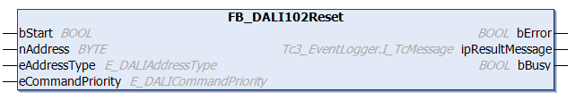

FB_DALI102Reset 1:
The function block resets all variables of the DALI control gear to their reset values.
Control gears can take up to 300 ms to execute the DALI command. Only then are further DALI commands executed by the respective DALI control gear.
FB_DALI102Reset 2:
The function block sends the DALI command RESET twice, as required by the DALI standard for certain DALI commands.
FB_DALI102Reset 3: Inputs
  bStart            : BOOL;
  nAddress          : BYTE;
Type
bStart
nAddress
BYTE
eAddressType
E_DALIAddressType
eCommandPriority
E_DALICommandPriority
FB_DALI102Reset 4:
FB_DALI102Reset 5: Outputs
Type
ipResultMessage
I_TcMessage
bBusy
FB_DALI102Reset 6: Properties
Type
Access
Initial value
ipDALICommunication
I_DALICommunication
Get, Set
NULL
