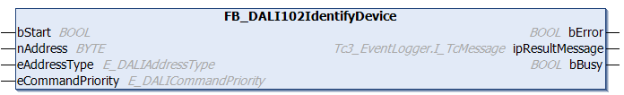

FB_DALI102IdentifyDevice
FB_DALI102IdentifyDevice 1:
The function block starts the identification routine for the DALI control gear.
It takes approx. 10 seconds and ends automatically. The exact scope of the identification routine depends on the manufacturer of the DALI control gear.
FB_DALI102IdentifyDevice 2:
The function block sends the DALI command IDENTIFY DEVICE twice, as required by the DALI standard for certain DALI commands.
FB_DALI102IdentifyDevice 3: Inputs
  bStart            : BOOL;
  nAddress          : BYTE;

FB_DALI102IdentifyDevice 4:
FB_DALI102IdentifyDevice 5: Outputs
