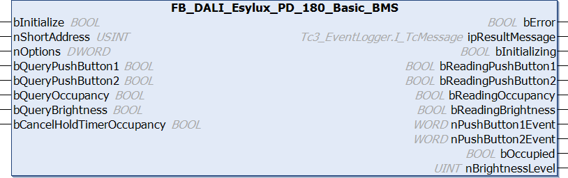

The function block represents the PD 180/16 BASIC BMS DALI-2 DALI sensor from Esylux.
This outputs two push button signals (instances 0 to 1), an occupancy signal (instance 2) and a measured brightness value (instance 3).
For information on the exact functions of the individual instances, please refer to the manufacturer's device documentation.
Further information on the supported instance types can be found here:
Part 301 (push buttons) – Introduction
Part 303 (occupancy sensors) – Introduction
Part 304 (light sensors) – Introduction
The existing parameters can be overwritten by changing the properties listed below. All parameters are written to the DALI control device by a positive edge at bInitialize and stored there.
The outputs with the output values of the DALI device only contain valid values if the function block was executed without errors (bError = FALSE). If the output bError = TRUE, the outputs with the output values must not be evaluated.
The reading can be triggered immediately via the input variables bQueryPushButtonN, bQueryOccupancy and bQueryBrightness, even if the corresponding instance is not enabled.

FB_DALI_Esylux_PD_180_Basic_BMS 4: Inputs
  bInitialize                : BOOL  := FALSE;
  nShortAddress              : USINT := 0;
  nOptions                   : DWORD := 0;
  bQueryPushButton1          : BOOL  := FALSE;
  bQueryPushButton2          : BOOL  := FALSE;
  bQueryOccupancy            : BOOL  := FALSE;
  bQueryBrightness           : BOOL  := FALSE;
  bCancelHoldTimerOccupancy  : BOOL  := FALSE;
Type
bInitialize
The configuration of the DALI control device is started by a positive edge at this input. During this time no DALI commands are processed.
nShortAddress
USINT
Short address (0…63) of the DALI control device.
nOptions
DWORD
Reserved for future extensions.
bQueryPushButtonN
The state of the push button is queried immediately by a positive edge at this input.
bQueryOccupancy
The occupancy is queried immediately by a positive edge at this input.
bQueryBrightness
The brightness is queried immediately by a positive edge at this input.
A positive edge at this input prematurely ends the Hold Timer and resets the output bOccupied.
FB_DALI_Esylux_PD_180_Basic_BMS 5: Outputs
  bError                     : BOOL;
  ipResultMessage            : I_TcMessage;
  bInitializing              : BOOL;
  bReadingPushButton1        : BOOL;
  bReadingPushButton2        : BOOL;
  bReadingOccupancy          : BOOL;
  bReadingBrightness         : BOOL;
  nPushButton1Event          : WORD;
  nPushButton2Event          : WORD;
  bOccupied                  : BOOL;
  nBrightnessLevel           : UINT;
