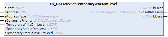

FB_DALI209SetTemporaryWAFDimLevel
FB_DALI209SetTemporaryWAFDimLevel 1:
The function block saves the values nTemporaryWhiteDimLevel, nTemporaryAmberDimLevel and nTemporaryFreeColourDimLevel in the variables temporaryWhiteDimLevel, temporaryAmberDimLevel and temporaryFreeColourDimLevel of the DALI control gear.
The values can be read with function block FB_DALI209QueryColourValue.
FB_DALI209SetTemporaryWAFDimLevel 2:
The function block changes the DTR0, DTR1 and DTR2 of all connected DALI control gears.
FB_DALI209SetTemporaryWAFDimLevel 3:
The function block supports the following color representations:
  • RGBWAF
FB_DALI209SetTemporaryWAFDimLevel 4: Inputs
  bStart                          : BOOL;
  nAddress                        : BYTE;
  eAddressType                    : E_DALIAddressType := E_DALIAddressType.Short;
  eCommandPriority                : E_DALICommandPriority := E_DALICommandPriority.MiddleLow;
  nTemporaryWhiteDimLevel         : USINT;
  nTemporaryAmberDimLevel         : USINT;
  nTemporaryFreeColourDimLevel    : USINT;
