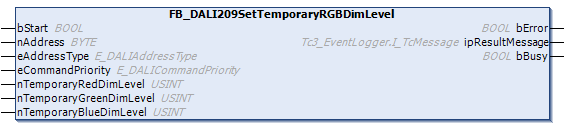

FB_DALI209SetTemporaryRGBDimLevel
The function block saves the values nTemporaryRedDimLevel, nTemporaryGreenDimLevel and nTemporaryBlueDimLevel in the variables temporaryRedDimLevel, temporaryGreenDimLevel and temporaryBlueDimLevel of the DALI control gear.
The values can be read with function block FB_DALI209QueryColourValue.
![]() | The function block changes the DTR0, DTR1 and DTR2 of all connected DALI control gears. |
![]() | The function block supports the following color representations:
Inputs
bStart : BOOL;
nAddress : BYTE;
nTemporaryRedDimLevel : USINT;
nTemporaryGreenDimLevel : USINT;
nTemporaryBlueDimLevel : USINT;
Name | Type | Description |
nTemporaryRedDimLevel |
USINT |
The value that is written to the variable temporaryRedDimLevel. |
nTemporaryGreenDimLevel |
USINT |
The value that is written to the variable temporaryGreenDimLevel. |
nTemporaryBlueDimLevel |
USINT |
The value that is written to the variable temporaryBlueDimLevel. |
Outputs
bError : BOOL;
bBusy : BOOL;
bBusy | BOOL | The output is set as soon as execution of the DALI commands has commenced. It remains active until all DALI commands have been processed. For some errors (e.g. faulty parameters), bError is set immediately after the positive edge at bStart without bBusy switching to TRUE. |
