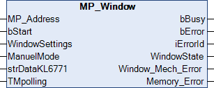

MP_Window
This function block is used to control and monitor a window ventilation system (FLS).
MP_Address is used to specify the MP-Bus device with which the function block is to communicate. bStart activates communication with the MP-Bus device. bBusy indicates that the function block is active. If bStart remains TRUE, the device is addressed cyclically with a period specified by the time in TMPolling. The time should be set longer than 1 second. bError is used to indicate an error in communication with the FLS. The type of the error can be read with iErrorID.
ManualMode can be used to enable or disable manual operation. The type of ventilation can be specified through WindowSettings.
Inputs
MP_Address : USINT := 1;
bStart : BOOL;
WindowSettings : Data_Window;
ManuelMode : BOOL;
strDataKL6771 : DataKL6771;
TMpolling : TIME := t#10s;
MP_Address | USINT | MP-Bus address of the slave. |
bStart | BOOL | A positive edge starts the function block. If this remains continuously TRUE, the function block will be activated cyclically with a period specified by the time in TMPolling. |
WindowSettings | Nominal ventilation settings. | |
ManuelMode | BOOL | FALSE = manual operation permitted, TRUE = manual operation disabled. |
strDataKL6771 | The data structure with which the KL6771() function block must be linked. | |
TMpolling | TIME | The time for which the function block should address the actuator. Default 10 s, minimum time 1 s. |
Outputs
bBusy : BOOL;
bError : BOOL;
iErrorId : MP_Error;
WindowState : Data_Window;
Window_Mech_Error : BOOL;
Memory_Error : BOOL;
bBusy | BOOL | This bit is set for as long as the function block is active. |
bError | BOOL | This output goes TRUE as soon as an error occurs. This error is described via the iErrorId variable. |
iErrorId | This output outputs an error code in the event of an error. bError goes TRUE at the same time. | |
WindowState | Current ventilation settings. | |
Window_Mech_Error | BOOL | The window or actuator is blocked |
Memory_Error | BOOL | The actuator has a memory error. Reprogram or replace. |
Requirements
Development environment | PLC library to include |
TwinCAT from v3.1.4020.14 | Tc2_MPBus from 3.3.5.0 |
