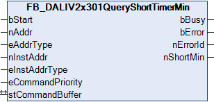

FB_DALIV2x301QueryShortTimerMin
The function block FB_DALIV2x301QueryShortTimerMin queries the minimum value of the SHORT TIMER.
The unit is 20 ms.
Inputs
bStart : BOOL;
nAddr : BYTE;
eAddrType : E_DALIV2AddrType := eDALIV2AddrTypeShort;
nInstAddr : BYTE := 0;
eInstAddrType : E_DALIV2InstAddrType := eDALIV2InstAddrTypeNumber;
eCommandPriority : E_DALIV2CommandPriority := eDALIV2CommandPriorityMiddle;
bStart | BOOL | The function block is activated by a positive edge at this input. |
nAddr | BYTE | The address of a device or of a group |
eAddrType | Short address, group address or broadcast | |
nInstAddr | BYTE | Address of the instance within the DALI control device |
eInstAddrType | Defines the access mode to the desired instance within the DALI control device. | |
eCommandPriority | Priority (high, medium or low) with which the command is processed by the library. |
Inputs/outputs
stCommandBuffer : ST_DALIV2CommandBuffer;
stCommandBuffer | ST_DALIV2CommandBuffer | Reference to the internal structure for communication with FB_KL6821Communication (KL6821). |
Outputs
bBusy : BOOL;
bError : BOOL;
nErrorId : UDINT;
nShortMin : BYTE;
bBusy | BOOL | When the function block is activated the output is set, and it remains active until execution of the command has been completed. |
bError | BOOL | This output is switched to TRUE as soon as an error occurs during the execution of a command. The command-specific error code is contained in nErrorId. Is reset to FALSE by the execution of a command at the inputs. |
nErrorId | UDINT | Contains the command-specific error code of the most recently executed command. Is reset to 0 by the execution of a command at the inputs (see error codes). |
nShortMin | BYTE | Value of the SHORT TIMER [20 ms] |
