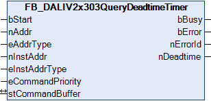

FB_DALIV2x303QueryDeadtimeTimer 2: Inputs
  bStart            : BOOL;
  nAddr             : BYTE;
  eAddrType         : E_DALIV2AddrType := eDALIV2AddrTypeShort;
  nInstAddr         : BYTE := 0;
  eInstAddrType     : E_DALIV2InstAddrType := eDALIV2InstAddrTypeNumber;
  eCommandPriority  : E_DALIV2CommandPriority := eDALIV2CommandPriorityMiddle;

FB_DALIV2x303QueryDeadtimeTimer 3: Inputs/outputs
  stCommandBuffer   : ST_DALIV2CommandBuffer;

FB_DALIV2x303QueryDeadtimeTimer 4: Outputs
  bBusy     : BOOL;
  bError    : BOOL;
  nErrorId  : UDINT;
  nDeadtime : BYTE;
