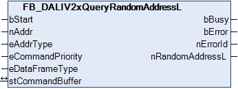

The function block FB_DALIV2xQueryRandomAddressL reads the low-order byte of the random address from the control device.
FB_DALIV2xQueryRandomAddressL 2: Inputs
  bStart            : BOOL;
  nAddr             : BYTE;
  eAddrType         : E_DALIV2AddrType := eDALIV2AddrTypeShort;
  eCommandPriority  : E_DALIV2CommandPriority := eDALIV2CommandPriorityMiddle;
  eDataFrameType    : E_DALIV2DataFrameType := eDALIV2DataFrameType24Bit;
Type
bStart
The function block is activated by a positive edge at this input.
nAddr
BYTE
The address of a device or of a group
eAddrType
E_DALIV2AddrType
Short address, group address or broadcast
eCommandPriority
Priority (high, medium or low) with which the command is processed by the library.
eDataFrameType
E_DataFrameType
Output format of the DALI command (eDALIV2DataFrameType24Bit or eDALIV2DataFrameTypeOsram)
FB_DALIV2xQueryRandomAddressL 3: Inputs/outputs
  stCommandBuffer   : ST_DALIV2CommandBuffer;
Type
stCommandBuffer
Reference to the internal structure for communication with FB_KL6821Communication (KL6821).
FB_DALIV2xQueryRandomAddressL 4: Outputs
  bBusy           : BOOL;
  bError          : BOOL;
  nErrorId        : UDINT;
  nRandomAddressL : BYTE;
Type
bBusy
This output is switched to TRUE as soon as an error occurs during the execution of a command. The command-specific error code is contained in nErrorId. Is reset to FALSE by the execution of a command at the inputs.
nErrorId
UDINT
Contains the command-specific error code of the most recently executed command. Is reset to 0 by the execution of a command at the inputs (see error codes).
nRandomAddressL
BYTE
The low-order byte of the random address/long address
