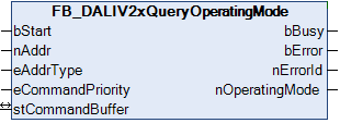

FB_DALIV2xQueryOperatingMode
FB_DALIV2xQueryOperatingMode 1:
The function block FB_DALIV2xQueryOperatingMode queries the Operating Mode of the control device.
FB_DALIV2xQueryOperatingMode 2: Inputs

FB_DALIV2xQueryOperatingMode 3: Inputs/outputs
  stCommandBuffer   : ST_DALIV2CommandBuffer;

FB_DALIV2xQueryOperatingMode 4: Outputs
  bBusy          : BOOL;
  bError         : BOOL;
  nErrorId       : UDINT;
  nOperatingMode : BYTE;
