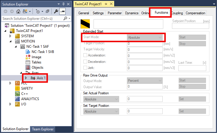

Velocity actual value - 6. In the Solution Explorer, click the axis.
- 7. Click the "Functions" tab.
- 8. In the drop-down menu "Start Mode": select "Reversing Sequence".
- 9. Adjust dynamics and velocity as needed in the real application.
