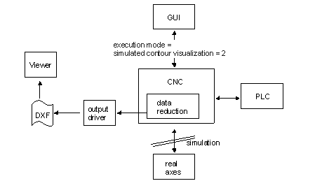

In some cases for testing or simulation a CNC program the program shall be executed without any real axes movements.
Rapid execution
In the simulation mode contour visualization the program is executed in a rapid mode, because the sample points are given in a coarse grid for interpolation.
Programmed dwell times (G04, #TIME) are also ignored.

Sample grid
The grid for the sample points can be parameterized by specifying a maximum sample point distance or by giving a maximum path error for secants.
The destination point of error NC block is reported in any case.
