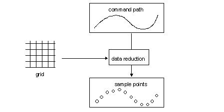

Corresponding to the given sample grid the movements blocks are segmented, and the axis positions are reported.
Sample point grid for linear blocks
For linear blocks the sample point distance for interpolation can be given directly. Therefore, the axis dynamics and the commanded velocity are not considered.
If the linear block is smaller than the given grid also the end point of the block is reported. By this the corners of the contour are always shown.
If the whole block is shorter than the grid distance, the endpoint is not reported. This is important if the whole NC program exists e.g. of short HSC blocks.
