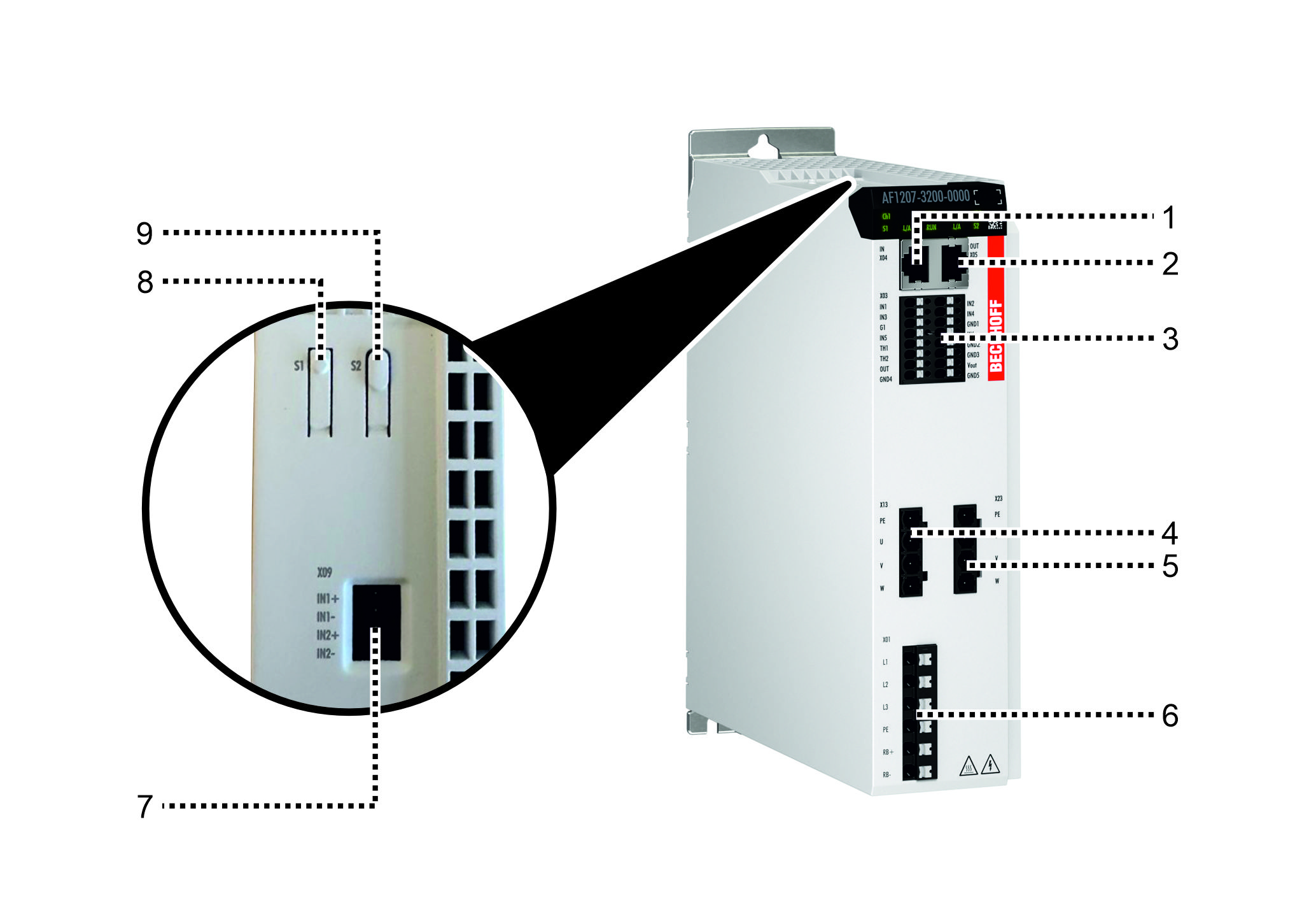

AF12xx-320x
Position | Labeling | Explanation |
1 | IN X04 | RJ45 socket for the incoming EtherCAT cable, see EtherCAT slot | IN X04, OUT X05 |
2 | OUT X05 | RJ45 socket for the downstream EtherCAT cable, see EtherCAT slot | IN X04, OUT X05 |
3 | X03 | Connection I/O: 16-pin terminal point for digital input/output signals, see I/O connection | X03 |
4 | X13 | Slot motor channel 1, see Motor slot | X13 |
5 | X23 | Slot motor channel 2, see Motor slot | X23 |
6 | X01 | Three-phase network connection, see Mains connection | X01 |
7 | X09 | TwinSAFE slot: safe inputs, see TwinSAFE slot | X09 |
8 | S1 | Push button for internal purposes |
9 | S2 | TwinSAFE actuation button |
