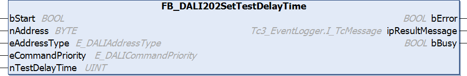

FB_DALI202SetTestDelayTime 5: Eingänge
  bStart                : BOOL;
  nAddress              : BYTE;
  eAddressType          : E_DALIAddressType := E_DALIAddressType.Short;
  eCommandPriority      : E_DALICommandPriority := E_DALICommandPriority.MiddleLow;
  eDimmingCurve         : E_DALIDimmingCurve := E_DALIDimmingCurve.Standard;
  nTestDelayTime        : UINT := 0;
