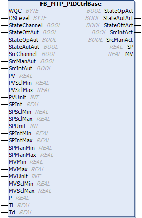

The function block FB_MTP_PIDCtrl is derived from FB_MTP_PIDCtrlBase. In this function block, the PID controller from the TwinCAT library Tc2_ControllerToolbox was implemented.
FB_MTP_PIDCtrl 2:
If an alternative PID controller is used, a function block with the same name can be created in the PLC project, which also inherits from FB_MTP_PIDCtrlBase.
Syntax
FUNCTION_BLOCK FB_MTP_PIDCtrl EXTENDS FB_MTP_PIDCtrlBase
    fbPid     : FB_CTRL_PID_EXT;
    PidParams : ST_Ctrl_PID_EXT_PARAMS;
SUPER^();
Inheritance hierarchy
FB_MTP_PIDCtrlBase
   FB_MTP_PIDCtrl

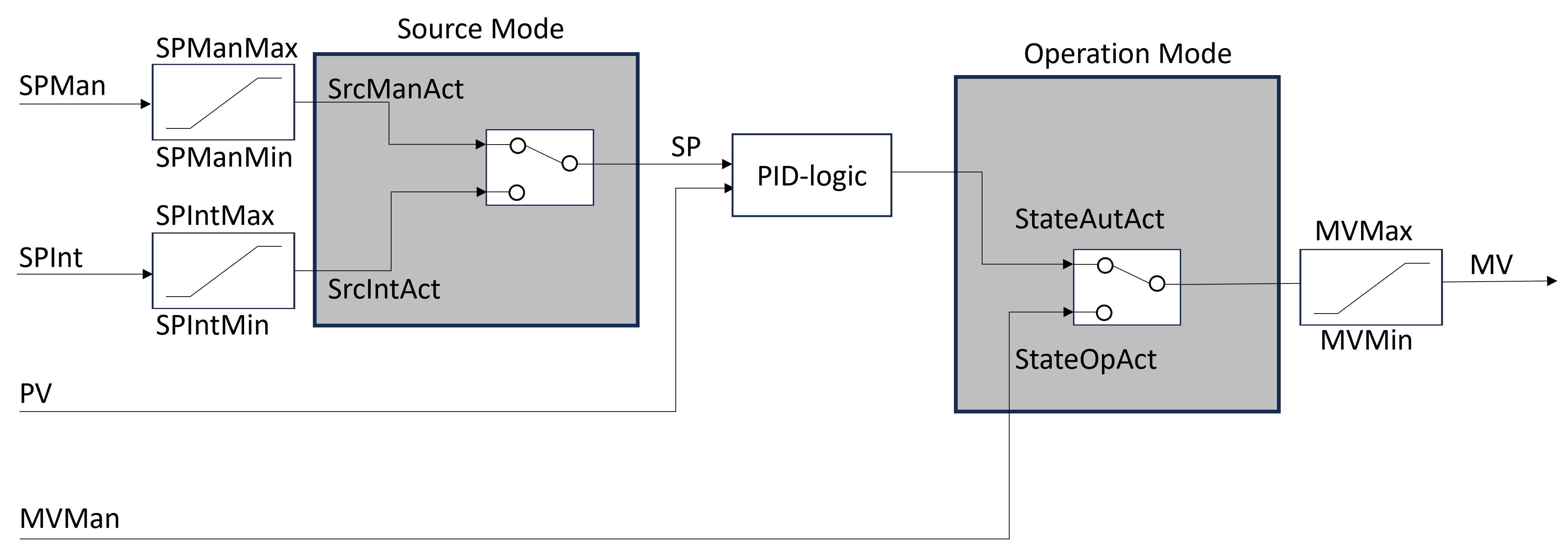

FB_MTP_PIDCtrl 3: Methods
PIDLogic
Implementation of the logic for calling the PID controller
ResetPID
Implementation of the logic for resetting the PID controller
