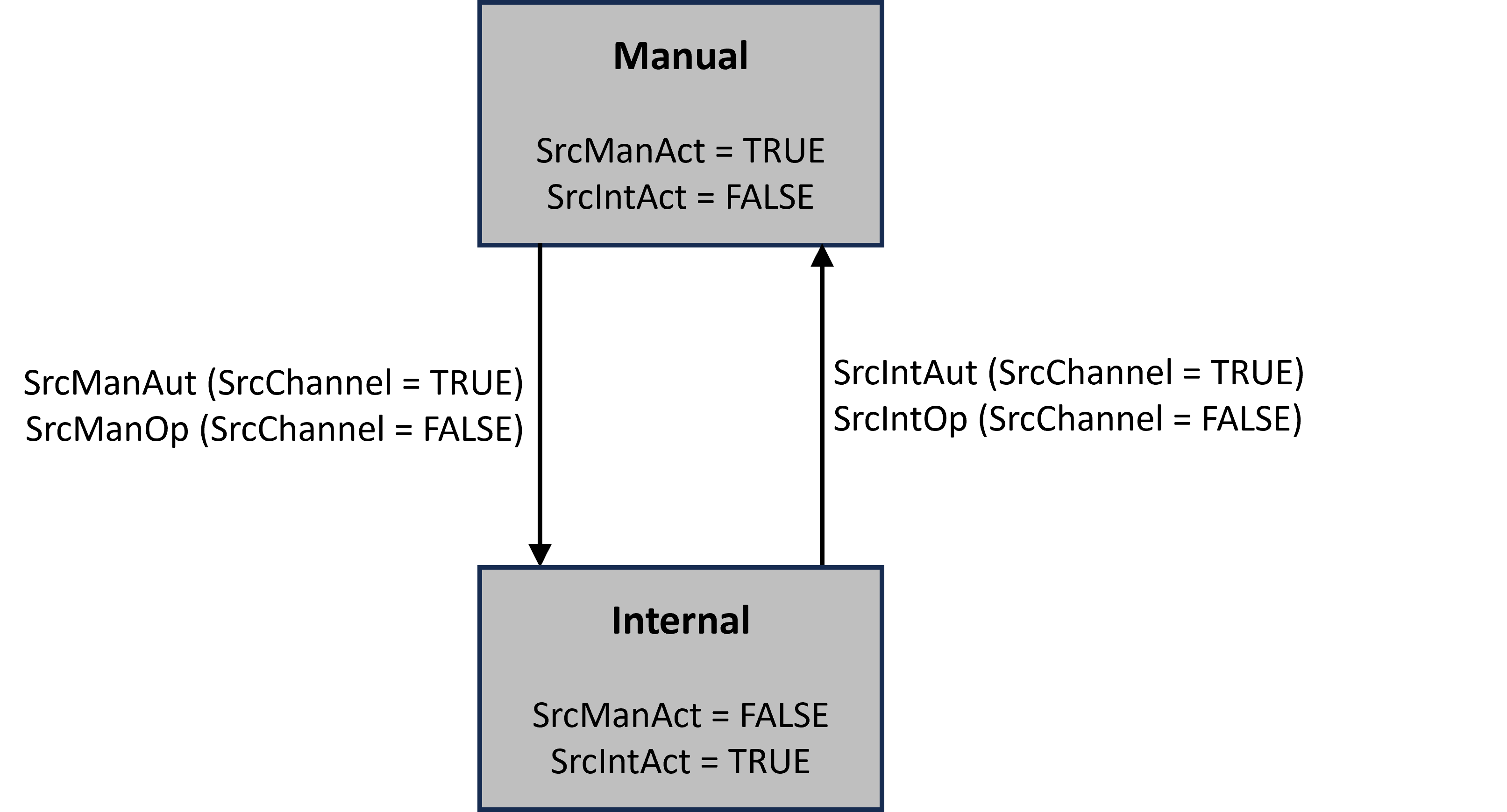

The state machine has two states: Internal, and Manual. In the Internal state, *Int value specifications are processed and in the Manual state, *Man value specifications are processed.
The current state is displayed via the outputs SrcManAct, and SrcIntAct.
State change
A state change is carried out via switching requests from the internal PLC logic *Aut or via an operator *Op (according to the Handshake procedure). The input SrcChannel is set via the internal PLC logic and indicates which source can currently trigger a state change.
If both state changes are requested simultaneously (e.g., SourceManAut = TRUE and SourceIntAut = TRUE), the requests are discarded and Source Mode remains in its current state.
