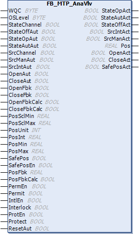

The function block FB_MTP_AnaVlv serves as an interface for controlling an analog valve from different sources: internal PLC logic or manual operation (e. g. via OPC UA). Switching requests and value specifications are managed independently of each other via the state machines of Operation Mode and Source Mode. The OPC UA access rights are described in the variable tables.
Controlling the valve
The specification for opening and closing the valve is made via the switching requests Open* and Close*. The state machine of the Operation Mode manages whether and from which source new switching requests are processed. For simultaneous requests from Open* and Close*, Close* has the highest priority. If Locking is active, control of the outputs via the switching requests is prevented or the safety position is assumed.
Setpoint specification
The position is specified via Pos* variables. The position specification is managed by the state machine of the Source Mode and output according to the diagram below:
FB_MTP_AnaVlv 2:
Safety position
The safety position is defined via the variables SafePosEn and SafePos .
The variable SafePosEn is used to describe whether the valve has a fixed safety position (SafePosEn = TRUE) or whether the current position should be maintained (SafePosEn = FALSE)
The safety position is described with SafePos:
SafePos = FALSE: Safety position of the valve: PosMin
SafePos = TRUE: Safety position of the valve: PosMax

FB_MTP_AnaVlv 3: Inputs
Type
OPC UA access
TagName
STRING
Name of the interface
TagDescription
STRING
Description of the interface
WQC
BYTE
Worst Quality Code
Read
OSLevel
BYTE
Level must be defined for system. Value 0 is reserved for local operation.
Read/write
State*
See Operation Mode
OpenAut
Automatic switching request to move to the selected position of the valve.
Read
CloseAut
Automatic switching request to close the valve.
Read
OpenFbkCaIc
Source of the feedback signal Limit switch Valve open:
1: Calculated
0: Sensor
Read
OpenFbk
Feedback signal Limit switch Valve open
Read
CloseFbkCaIc
Limit switch Valve closed:
1: Calculated
0: Sensor
Read
CloseFbk
Feedback signal Limit switch Valve closed.
Read
Src*
See Source Mode
PosInt
REAL
Internal value specification for the position
Read
PosUnit
INT
Unit of the position
Read
PosMin
REAL
Lower limit of the value specification for the valve position
Read
PosMax
REAL
Upper limit of the value specification for the valve position
Read
PosFbkCaIc
Source of the position feedback value:
1: Calculated
0: Sensor
Read
PosFbk
REAL
Feedback value of the position
Read
PosScIMin
REAL
Scale start of the position display
Read
PosScIMax
REAL
Scale end of the position display
Read
Perm*
Int*
Prot*
See Locking
SafePosEn
Use the safe position of the valve:
1: Use safe position.
0: Do not use safe position (Hold position).
Read
SafePos
Safe position of the valve:
1: PosMax
0: PosMin
Read
ResetAut
Automatic reset switching request:
1: Reset requested.
0: No reset requested.
Read
FB_MTP_AnaVlv 4: Outputs
Type
OPC UA access
State*
See Operation Mode
OpenAct
Open valve switching command.
Read
CloseAd
Close valve switching command.
Read
Src*
See Source Mode
Pos
REAL
Position setpoint on valve
Read
SafePosAct
Safe position:
1: Move to a safe position
0: Normal operation
Read
External variables
Type
OPC UA access
State*
See Operation Mode
OpenOp
Operator switching request to move to the selected position of the valve.
Read/write
CloseOp
Operator switching request to close the valve.
Read/write
Src*
See Source Mode
PosMan
Manual value specification for the position
Read/write
PosRbk
REAL
Unprocessed value of the Operator Value specification for the position
Read/write
ResetOp
Operator reset switching request:
0→1: Operator request
1→0: Request has been processed.
Read/write
FB_MTP_AnaVlv 5: Methods
SetOffline
SetOperator
SetAutomatic
See Operation Mode
SetInternal
SetManual
See Source Mode
