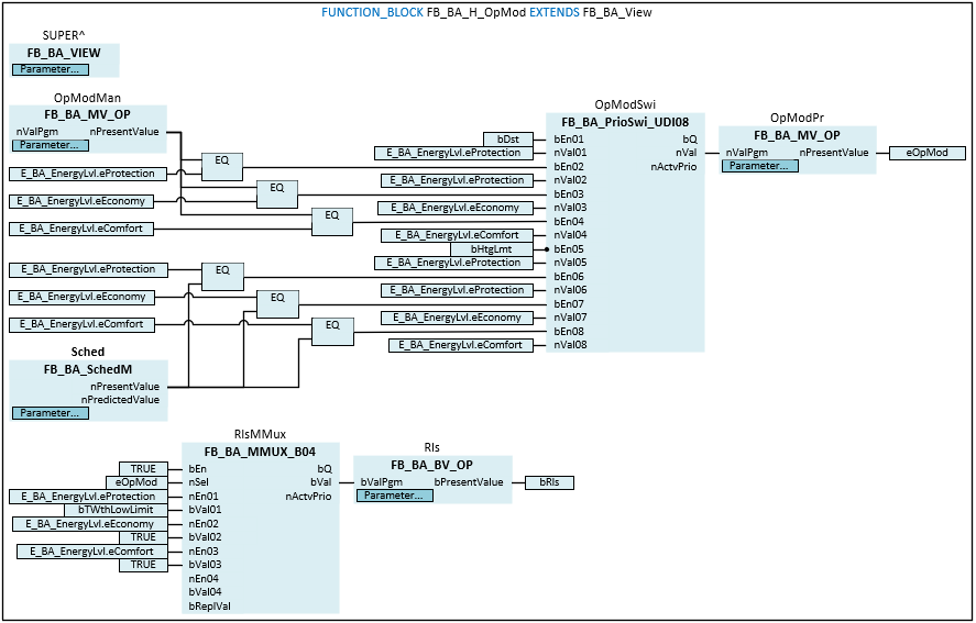

The FB_BA_H_OpMod template represents the operation mode and enable of a heating circuit.
The OpModSwi priority switch prioritizes various events or commands such as heating circuit fault, requests from the schedule or requests from the plant selector switch and writes a resulting operation mode or system status to the eOpMode variable.

Block diagram

VAR_INPUT CONSTANT
OpModMan : FB_BA_MV_Op;
Sched : FB_BA_SchedM;
OpModPr : FB_BA_MV_Op;
Rls : FB_BA_BV_Op;
OpModSwi : FB_BA_PrioSwi_UDI08;
RlsMMux : FB_BA_MMUX_B04;

Inputs CONSTANT
Name | Type | Description |
OpModMan | The MV object serves as plant selector switch. The following operation modes can be set: Auto, Protection, Economy and Comfort. The Auto operation mode means that the Sched schedule specifies the operation mode. | |
Sched | Schedule for switching between the Protection, Economy and Comfort operation modes. | |
OpModPr | Current operation mode of the heating circuit. | |
Rls | Indicates the enable of the heating circuit. |
Variables
OpModSwi | Priority switch for the operation modes of the heating circuit. | |
RlsMMux | The multiplexer converts the eOpMod operation mode into the bRls enable. |
