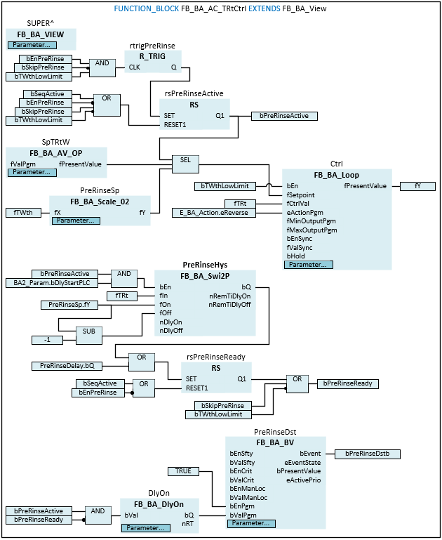

The template is used for open-loop and closed-loop control of the return temperature of a hot water air heater.
To prevent frost damage, the heating coil of the ventilation system is first preheated with warm water when the outside temperature is low.
To do this, the flip-flop rsPreRinseActive is first set in the template FB_BA_AC_TRtCtrl. The return temperature controller Ctrl receives the pre-rinse setpoint from the setpoint curve PreRinseSp via the selector. To prevent the heating coil from overheating during preheating, the pre-rinse setpoint is varied by the characteristic curve PreRinseSp depending on the outside temperature. When the desired return temperature is reached, the hysteresis module PreRinseHys switches on. The flip-flop rsPreRinseReady is then set.
The system start program FB_BA_AC_PlantCmd_AHU_1st_10 is informed via the output bPreRinseReady that it can continue with the next step, e.g. Opening the outdoor air damper.
The flip-flop rsPreRinseActive remains set so that the pre-rinse setpoint is still present at the return temperature controller.
If the system start program has switched on the fans and enabled the supply air temperature control in its subsequent steps, the flip-flop rsPreRinseActive is reset using the input bSeqActive. The pre-rinse process is now complete. For permanent frost protection operation of the heating coil during system operation and system standstill, the return temperature controller receives the reduced setpoint of the AV object SpTRtW. The output bQ of the function block PreRinseDelay becomes TRUE if the pre-rinse process is started and the pre-rinse setpoint is not reached after a delay time has elapsed. The fault is reported using the BV object PreRinseDst.

Block diagram
