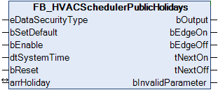

This function block is a yearly scheduler in which, e.g., school holidays or factory shutdowns can be entered. The function block is enabled by the input variable bEnable. The input dtSystemTime is linked to the current system time. The output bOutput is set if the switching conditions are satisfied. Besides the switching signal, the switch-on and switch-off edges plus the next switch-on or switch-off time as a countdown are available as outputs. The data of the channels is transferred as a reference. The function block is therefore able to check the data for changes and to save it as persistent data. After booting, the data are thus available to the BMS again. As opposed to the FB_HVACSchedulerSpecialPeriods, only daily switching is possible here.
FB_HVACSchedulerPublicHolidays 2:
If the input variable bEnable = FALSE, then the output bOutput = FALSE. The channels arrHoliday remain active.
eDataSecurityType    : E_HVACDataSecurityType;
bSetDefault          : BOOL;
bEnable              : BOOL;
dtSystemTime         : DT;
bReset               : BOOL;
Notice
bEnable: The function block is enabled by the variable bEnable. If bEnable = FALSE there is no switching at the output bOutput.
dtSystemTime: The variable dtSystemTime transfers the computer system time to the timer program.
bReset: Acknowledge input in the event of a fault. Resets the flag bInvalidParameter.
bOutput            : BOOL;
bEdgeOn            : BOOL;
bEdgeOff           : BOOL;
tNextOn            : TIME;
tNextOff           : TIME;
bInvalidParameter  : BOOL;
bOutput: Is TRUE if one of the timer switch channels has switched on.
bEdgeOn: Is TRUE for one PLC cycle after bOutput switches on.
bEdgeOff: Is TRUE for one PLC cycle after bOutput switches off.
tNextOn: Time until the next switch-on of the timer program (max. 50 days).
tNextOff: Time until the next switch-off of the timer program (max. 50 days).
bInvalidParameter: An error occurred during the plausibility check. It is deleted again by bReset.
arrHoliday   : ARRAY[1..20] OF ST_HVACHoliday;
arrHoliday: The variable arrHoliday is an array with 20 declarations of the structure variable ST_HVACHoliday (see ST_HVACHoliday).
For each instance of the function block FB_HVACSchedulerPublicHolidays it is necessary to create an array of type ST_HVACHoliday. The size of the array must be 20, since the function block processes a total of 20 time channels and expects these as a reference (VAR_IN_OUT).

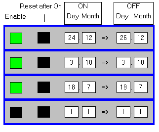

Each channel is enabled with the variable bEnable (On/Off). If bEnable = FALSE, then the channel is deactivated and the times entered have no effect. For one-shot events, the variable bResetAfterOn (non-recurring) is activated. After the time set in this channel has elapsed, the entries created under uiOn_Day, uiOff_Day, uiOn_Month and uiOff_Month are retained. However, the variable bEnable (On/Off) is reset to FALSE. In this manner a one-shot event can be defined once and reactivated whenever it is required.
Example
FB_HVACSchedulerPublicHolidays 3:
switched on from 24/12 00:00 until 26/12 23:59:59
switched on from 03/10 00:00 until 03/10 23:59:59
switched on from 18/07 00:00 until 19/07 23:59:59
1.1. until 1.1. channel not activated, always switched off!
