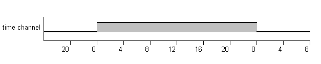

Switch-on time 00:00:00: Switch on begins at 0.00 on the selected day.
Switch-off time 00:00:00: Switch-off takes place at 23:59:59 on the selected day.

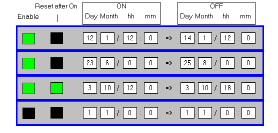

Each channel is enabled via the variable bEnable (On/Off). If bEnable = FALSE, then the channel is deactivated and the times entered have no effect. For one-shot events, the variable bResetAfterOn (non-recurring) is activated. After the time set in this channel has elapsed, the entries created under uiOn_hh, uiOn_mm, uiOff_hh, uiOff_mm, uiOn_Day, uiOff_Day, uiOn_Month and uiOff_Month are retained. However, the variable bEnable (On/Off) is reset to FALSE. In this manner a one-shot event can be defined once and reactivated whenever it is required.
Example:
12/01 switched on from 12:20 until 14/01 at 12:00
switched on from 23/06 00:00 until 25/08 23:59:59
switched on from 03/10 12:00 until 03/10 at 18:00, one-shot!
1.1. until 1.1. channel not activated, always switched off!
