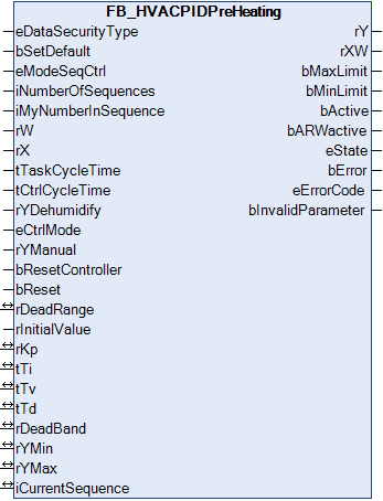

This function block is a special application of a PID controller.
Besides the PID control algorithm, the block contains the conditions for changing to the sequence of the previous or next sequence controller. A special feature of the pre-heating controller is the input rYDehumidify. As soon as the signal of rYDehumidify is greater than zero, the preheater is disabled and the value of iCurrentSequence is incremented by one. As a result of this the reheater FB_HVACPIDReHeating is activated in place of the preheater. If the value of rYDehumidify returns to zero, the preheater is automatically reactivated. Outside the normal sequence control operation the controller is also activated in the case of backup operation (freeze protection).
eDataSecurityType : E_HVACDataSecurityType;
bSetDefault : BOOL;
eModeSeqCtrl : E_HVACSequenceCtrlMode;
iNumberOfSequences : INT;
iMyNumberInSequence : INT;
rW : REAL;
rX : REAL;
tTaskCycleTime : TIME;
tCtrlCycleTime : TIME;
rYDehumidify : REAL;
eCtrlMode : E_HVACCtrlMode;
rYManual : REAL;
rInitialValue : REAL;
bResetController : BOOL;
bReset : BOOL;

rY : REAL;
rXW : REAL;
bMaxLimit : BOOL;
bMinLimit : BOOL;
bActive : BOOL;
bARWactive : BOOL;
eState : E_HVACState;
bError : BOOL;
eErrorCode : E_HVACErrorCodes;
bInvalidParameter : BOOL;
