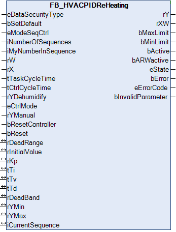

FB_HVACPIDReHeating
The reheater is used to reheat the supply air that was cooled down by the cooler for dehumidification. The controller can only be enabled within the normal sequence control operation.
eDataSecurityType : E_HVACDataSecurityType;
bSetDefault : BOOL;
eModeSeqCtrl : E_HVACSequenceCtrlMode;
iNumberOfSequences : INT;
iMyNumberInSequence : INT;
rW : REAL;
rX : REAL;
tTaskCycleTime : TIME;
tCtrlCycleTime : TIME;
rYDehumidify : REAL;
eCtrlMode : E_HVACCtrlMode;
rYManual : REAL;
bResetController : BOOL;
bReset : BOOL;
Notice | |
A cyclically changing variable must never be linked with the IN_OUT variable of a function block, if eDataSecurityType:= eHVACDataSecurityType_Persistent. It would lead to early wear of the flash memory. |
eModeSeqCtrl: Among other things, control is enabled via this enum (see E_HVACSequenceCtrlMode). In addition, the operation mode of the VAC system is transmitted to the controller blocks in the sequence. See also Table operation modes.
iNumberOfSequences: Number of sequence controllers in the system.
iMyNumberInSequence: The controller’s own number in the sequence.
rW: The setpoint is transferred to the controller with the variable rW.
rX: Actual value of the control loop.
tTaskCycleTime: Cycle time with which the function block is called. If the function block is called in every cycle this corresponds to the task cycle time of the calling task.
tCtrlCycleTime: The variable tCtrlCycleTime specifies the cycle time with which the PID controller is processed. The shortest possible cycle time is that of the controller. Since the controlled systems in building automation are predominantly slow, the cycle time of the controller can be several times that of the control cycle time.
rYDehumidify: Constant value.
eCtrlMode: The operation mode is selected via this enum (see E_HVACCtrlMode). Manual or automatic operation mode.
rYManual: Manual value that is set at the output rY if eCtrlMode = eHVACCtrlMode_Manual.
bResetController: A positive edge on the input bResetController resets the PID controller.
bReset: Acknowledge input in the event of a fault.
rY : REAL;
rXW : REAL;
bMaxLimit : BOOL;
bMinLimit : BOOL;
bActive : BOOL;
bARWactive : BOOL;
eState : E_HVACState;
bError : BOOL;
eErrorCode : E_HVACErrorCodes;
bInvalidParameter : BOOL;
rY: Control signal output of the PID controller.
rXW: Control deviation.
bMaxLimit: The output bMaxLimit is TRUE if the output rY has reached the value rYMax.
bMinLimit: The output bMinLimit is TRUE if the output rY has reached the value rYMin.
bActive: bActive is TRUE if the controller is active and enabled.
bARWactive: bARWactive is TRUE if the integral component of the controller has reached the lower or upper control variable limit.
eState: State of the controller (see E_HVACState).
bError: This output indicates with a TRUE that there is an error.
eErrorCode: E_HVACErrorCodes (see E_HVACErrorCodes).
bInvalidParameter: TRUE if an error has occurred during the plausibility check. The message must be acknowledged with bReset.
rDeadRange : REAL;
rInitialValue : REAL;
rKp : REAL;
tTi : TIME;
tTv : TIME;
tTd : TIME;
rDeadBand : REAL;
rYMin : REAL;
rYMax : REAL;
iCurrentSequence: INT;
rDeadRange: In order to avoid unnecessary driving and hence premature wear of the valves or damper drives, a dead range can be set for the controller output signal rY. This means that a control signal change is only active if the change of value is greater than the dead range. A constant change of the control signal rY is converted to a pulsating drive of the actuator if a dead range is specified. The larger the dead range the larger the pauses and the control signal jumps will be. The variable is saved persistently. Preset to 0.
rInitialValue: The restart behavior of the controller is influenced by rInitialValue. The variable is saved persistently. Preset to 0.
rKp: Proportional factor amplification. The variable is saved persistently. Preset to 0.
tTi: Integration time. The I-component corrects the residual control deviation following correction of the P-component. The smaller the tTi time is set, the faster the controller corrects. The control loop becomes unstable if the time is too short. Larger tTi-times must be entered in order to reduce the integration component. The integral action time should be selected to be longer than the stroke time of the valve or damper actuator. The variable is saved persistently. Preset to 30 s.
tTv: Rate time. The larger tTv is, the stronger the controller corrects. The control loop becomes unstable if the time is too long. Often in normal building automation applications only a PI controller is used. In this case zero must be entered for tTv. The variable is saved persistently. Preset to 0 s.
tTd: Damping time. The variable is saved persistently. Preset to 0 s.
rDeadBand: If the control value is at the lower or upper limit of a controller and the actual value of the controlled system oscillates around the set value with a small amplitude, frequent switching back and forth between two sequence controllers can be damped by an additional parameter for the switchover. To this end, the difference between the actual and set values of the controlled system is integrated after the sequence controller has reached its lower or upper limit. Switching to the next sequence only takes place if the sum of this integration is greater than the value of rDeadband (See Example). The variable is saved persistently. Preset to 0.
rYMin: Lower limit of the working range of the controller. The variable is saved persistently. Preset to 0.
rYMax: Upper limit of the working range of the controller. The variable is saved persistently. Preset to 100.
iCurrentSequence: Number of the active controller from the sequence.
