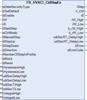

eDataSecurityType : E_HVACDataSecurityType;
bSetDefault : BOOL;
bEnable : BOOL;
rW : REAL;
rX : REAL;
iStartStep : INT;
eCtrlMode : E_HVACCtrlMode;
iManualStep : INT;
bStepUp : BOOL;
bStepDown : BOOL;
bDirection : BOOL;
iNumberOfStepInProfile : INT;
bBlock : BOOL;
bReset : BOOL;
Notice | |
A cyclically changing variable must never be linked with the IN_OUT variable of a function block, if eDataSecurityType:= eHVACDataSecurityType_Persistent. It would lead to early wear of the flash memory. |
bEnable: The function block is enabled via TRUE. If bEnable = FALSE, then iStep is set constantly to 0. The check of the variable iNumberOfStepInProfile remains active. If an error occurs, it is displayed with bError = TRUE and can be acknowledged with bReset once the fault has been corrected.
rW: The setpoint is transferred with the rW variable.
rX: The variable rX is used to transfer the actual value.
iStartStep: If the function block is enabled (bEnable = TRUE) and there is no error (bError = FALSE), then iStep = iStartStep for one PLC cycle.
eCtrlMode: Enum that specifies the operation mode of the function block. If bEnable = TRUE AND bError = FALSE AND eCtrlMode = eHVACCtrlMode_Manual AND iNumberOfStepInProfile > 0, then the value of the output iStep can be specified via iManualStep. On starting the PLC, eCtrlMode = eHVACCtrlMode_Auto.
iManualStep: If the operation mode eCtrlMode = eHVACCtrlMode_Manual AND bEnable = TRUE AND bError = FALSE AND iNumberOfStepInProfile > 0, then the value of the output iStep can be specified via iManualStep. The input range of iManualStep can be 0 at the least and the value of iNumberOfStepInProfile at the most.
bStepUp: If bEnable = TRUE AND bError = FALSE AND eCtrlMode = eHVACCtrlMode_Auto AND bBlock = FALSE, then the value of the output iStep can be incremented by 1 by a rising edge at the input bStepUp. This can be repeated until iStep = iNumberOfStepInProfile.
bStepDown: If bEnable = TRUE AND bError = FALSE AND eCtrlMode = eHVACCtrlMode_Auto AND bBlock = FALSE, then the value of the output iStep can be decremented by 1 by a rising edge at the input bStepDown. This can be repeated until iStep = 0.
bDirection: bDirection determines the control direction of the function block. FALSE = heating mode; TRUE = cooling mode
iNumberOfStepInProfile: Number of steps in the power step sequence. iNumberOfStepInProfile can be 0 at the least and the value of g_iMaxNumberOfSteps at the most. If the limit values are not adhered to, an error is output and displayed by bError = TRUE and iStep becomes 0.
bBlock: Using the input variable bBlock, the control of the function block can either be released or the output iStep is set to the value to the variable iNumberOfStepInProfile.
If bEnable = TRUE AND bError = FALSE AND eCtrlMode = eHVACCtrlMode_Auto AND bBlock = FALSE, then the I-transfer element and the internal timing elements are enabled for the control of the output iStep.
If bEnable = TRUE AND bError = FALSE AND eCtrlMode = eHVACCtrlMode_Auto AND bBlock = TRUE, then the I-transfer element and the internal timing elements are blocked and iStep = iNumberOfStepInProfile.
bReset: Input for acknowledgement of the faults once they have been corrected. Internally the system responds to a rising edge.
iStep : INT;
rI_Ctrl : REAL;
rE : REAL;
rW_High : REAL;
rW_Low : REAL;
b_rW_High : BOOL;
b_rW_Low : BOOL;
udiSecRT_DelayHigh : UDINT;
udiSecRT_DelayLow : UDINT;
bError : BOOL;
eErrorCode : E_HVACErrorCodes;
iStep: The output variable iStep indicates the step in a power step sequence. iStep = iStartStep on starting the function block if bEnable = TRUE AND bError = FALSE. iStep can reach the value of iNumberOfStepInProfile at the most and can be 0 at the least.
The value of iStep can be specified manually via iManualStep if bEnable = TRUE, bError = FALSE AND eCtrlMode = eHVACCtrlMode_Manual.
The value of iStep can be incremented or decremented via the input variables bStepUp / bStepDown if bEnable = TRUE, bError = FALSE, eCtrlMode = eHVACCtrlMode_Auto AND bBlock = FALSE.
If bEnable = TRUE, bError = FALSE, eCtrlMode = eHVACCtrlMode_Auto AND bBlock = FALSE and the value of iStep has changed, then the delay timing elements and the I-transfer element are reset.
If bEnable = TRUE, bError = FALSE, eCtrlMode = eHVACCtrlMode_Auto, bBlock = FALSE AND iNumberOfStepInProfile > 0, the output of the I-transfer element rI_Ctrl = rIntegralHigh or rIntegralLow and one of the delay times tRemainingTimeDelayHigh / tRemainingTimeDelayLow = T#0s, then the output iStep is controlled as follows:
iStep = iStep + 1 if
(rX < rW_Low AND iStep < iNumberOfStepInProfile AND NOT bDirection)
OR
(rX >= rW_High AND iStep < iNumberOfStepInProfile AND bDirection).
iStep = iStep -1 if
(rX < rW_Low AND iStep > 0 AND bDirection)
OR
(rX >= rW_High AND iStep > 0 AND NOT bDirection), see Program flowchart
rI_Ctrl: Output of the I-transfer element.
If rI_Ctrl >= rIntegralHigh or rIntegralLow and tRemainingTimeDelayHigh or tRemainingTimeDelayLow = T#0s, then the number of steps is incremented or decremented by 1 via iStep. Subsequently, the I-transfer element and the timing elements for stepping up or down are reset, so that stepping up or down is restarted, see Program flowchart.
rE: Control deviation with which the internal I-transfer element works: rE = rW - rX
rW_High: rW_High := rW + rHysteresisHigh – upper setpoint limit which, when exceeded by rX, causes the I-transfer element to be activated first, followed by the timing element of the delay time udiSecDelayHigh; see Functional description or Behavior of different variables.
rW_Low: rW_Low := rW - rHysteresisLow – lower setpoint limit which, when undershot by rX, causes the I-transfer element to be activated first, followed by the timing element of the delay time udiSecDelayLow; see Functional description or Behavior of different variables.
b_rW_High: b_rW_High goes TRUE if rX > rW_High.
b_rW_Low: b_rW_Low goes TRUE if rX < rW_Low.
udiSecRT_DelayHigh: Remaining time of the delay time udiSecDelayHigh.
udiSecRT_DelayLow: Remaining time of the delay time udiSecDelayLow.
bError: This output signals with a TRUE that there is an error and that there is a wrong parameter on the variable iNumberOfStepInProfile. iStep is set constantly to 0 and the Enum eErrorCode indicates the error code. Once the fault has been corrected the bError message must be acknowledged with bReset.
eErrorCode: Returns the error number if a bError output is set (see E_HVACErrorCodes). The following error can occur in this function block: eHVACErrorCodes_InvalidParam_NumberOfStepInProfile
![]() | To access the enum error number in the PLC eErrorCode can assigned to a variable of data type WORD. eHVACErrorCodes_Error_iNumberOfStepInProfil= 32 |
rHysteresisHigh : REAL;
rHysteresisLow : REAL;
udiSecDelayHigh : UDINT;
udiSecDelayLow : UDINT;
udiSecTiHigh : UDINT;
udiSecTiLow : UDINT;
rIntegralHigh : REAL;
rIntegralLow : REAL;
rHysteresisHigh: Positive value of the upper limit of the control deviation; see Functional description or Behavior of different variables. rW_High := rW + rHysteresisHigh. The variable is saved persistently. Preset to 5.
rHysteresisLow: Positive value of the lower limit of the control deviation; see Functional description or Behavior of different variables. rW_Low := rW – rHysteresisLow. The variable is saved persistently. Preset to 5.
udiSecDelayHigh: Delay time (0..g_udiMaxSec) after whose expiry iStep is incremented or decremented, see Functional description or Behavior of different variables. The variable is saved persistently. Preset to 300 s.
udiSecDelayLow: Delay time (0..g_udiMaxSec) after whose expiry iStep is incremented or decremented, see Functional description or Behavior of different variables. The variable is saved persistently. Preset to 300 s.
udiSecTiHigh: Integration time (0..g_udiMaxSec) for the upper limit of the I-transfer element in seconds; see Functional description or Behavior of different variables. udiSecTiHigh must be > 0. Otherwise the default value or the last valid variable value is used internally. The variable is saved persistently. Preset to 60 s.
udiSecTiLow: Integration time (0..g_udiMaxSec) for the lower limit of the I-transfer element; see Functional description or Behavior of different variables. udiSecTiLow must be > 0. Otherwise the default value or the last valid variable value is used internally. The variable is saved persistently. Preset to 60 s.
rIntegralHigh: Positive value for the upper limit at which the integration of the I-transfer element is stopped (anti-reset-windup measure) and one of the delay times starts; see Functional description or Behavior of different variables. The variable is saved persistently. Preset to 15.
rIntegralLow: Positive value for the lower limit at which the integration of the I-transfer element is stopped (anti-reset-windup measure) and one of the delay times starts; see Functional description or Behavior of different variables. The variable is saved persistently. Preset to 15.
