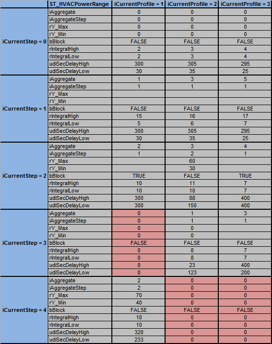

Table example for the power range table arrPowerRangeTable
A unit is assigned to each power step within a profile (table columns).
Hence, the order is specified in which the power generators are switched on or off within a sequence.
The power of the units is specified as 0 to 6 in the case of stepped power generators or 0 to 100% in the case of constant power generators.

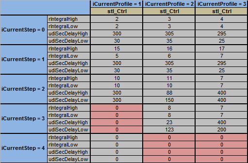

The relationship between the power range table arrPowerRange and the output structures stAggregate1-6 and stI_Ctrl is to be described in greater detail on the basis of the table example:
  1. The column iCurrentProfile = 1 is intended to represent the first profile of the power range table arrPowerRange. In this profile the output iNumberOfStepInProfile has the value 2, because no variable value in the structure ST_HVACPowerRange (marked red) is greater than 0 in the line iCurrentStep = 3.

  9. The column iCurrentProfile = 2 represents the second profile of the power range table arrPowerRange. In this profile the output iNumberOfStepInProfile has the value 3, because no variable value in the structure ST_HVACPowerRange (marked red) is greater than 0 in the line iCurrentStep = 4.
    If one assumes that the current power step iCurrentStep has the value 3, then the variable values are output as follows on the output structures:

  17. The column iCurrentProfile = 3 represents the third profile of the power range table arrPowerRange. In this profile the output iNumberOfStepInProfile has the value 3, because no variable value in the structure ST_HVACPowerRange (marked red) is greater than 0 in the line iCurrentStep = 4.

Output structure stI_Ctrl adjusted to the example

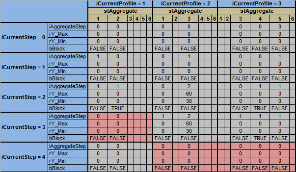

FB_HVACPowerRangeTable 4:
Output structures stAggregate1-6 adjusted to the example

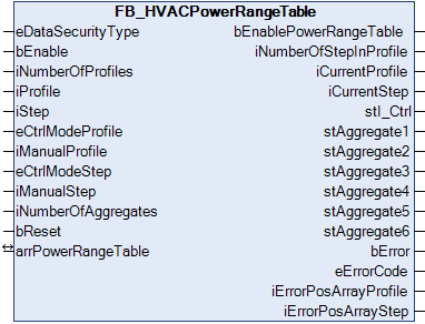

FB_HVACPowerRangeTable 5:
eDataSecurityType     : E_HVACDataSecurityType;
bEnable               : BOOL;
iNumberOfProfiles     : INT;
iProfile              : INT;
iStep                 : INT;
eCtrlModeProfile      : E_HVACCtrlMode;
iManualProfile        : INT;
eCtrlModeStep         : E_HVACCtrlMode;
iManualStep           : INT;
iNumberOfAggregates   : INT;
bReset                : BOOL;
Notice
bEnable: The function block is enabled via TRUE. If bEnable = FALSE, then all output variables and output structures are set constantly to 0. The checking of the variables iNumberOfProfiles, iProfile, iStep, iNumberOfStepInProfile, iNumberOfAggregates, arrPowerRangeTable[X,X].iAggregate, arrPowerRangeTable[X,X].iAggregateSteps, arrPowerRangeTable[iP,iS].udiSecDelayHigh, and arrPowerRangeTable[iP,iS].udiSecDelayLow remains active. If an error occurs, it is displayed with bError = TRUE and can be acknowledged with bReset once the fault has been corrected.
iNumberOfProfiles: The number of parameterized profiles in the power range table arrPowerRangeTable. The indication of the number of profiles must not be lower than g_iMinNumberOfProfiles and must not be greater than g_iMaxNumberOfProfiles. Otherwise an error is indicated by bError = TRUE and the execution of the function block is stopped.
iProfile: Indicates the current profile with which the function block from the power range table arrPowerRangeTable [iCurrentProfile, iCurrentStep] is working. If eCtrlModeProfile = eHVACCtrlMode_Auto, then iCurrentProfile = iProfile. The indication of the profile must not be lower than g_iMinNumberOfProfiles and must not be greater than iNumberOfProfiles. Otherwise an error is indicated by bError = TRUE and the execution of the function block is stopped.
iStep: Indicates the current step with which the function block from the power range table arrPowerRangeTable[iCurrentProfile, iCurrentStep] is working. If eCtrlModeStep = eHVACCtrlMode_Auto, then iCurrentStep = iStep. The indication of the steps must not be smaller than g_iMinNumberOfSteps and must not be greater than iNumberOfStepInProfile. Otherwise an error is indicated by bError = TRUE and the execution of the function block is stopped.
eCtrlModeProfile: The input variable via which the profile from the power range table arrPowerRangeTable [iCurrentProfile, iCurrentStep] is specified is decided via this enum (see E_HVACCtrlMode). If eCtrlModeProfile = eHVACCtrlMode_Auto, then iCurrentProfile = iProfile. If eCtrlModeProfile = eHVACCtrlMode_Manual, then iCurrentProfile = iManualProfile.
iManualProfile: Indicates which profile from the power range table arrPowerRangeTable[iCurrentProfile, iCurrentStep] is in use. If eCtrlModeProfile = eHVACCtrlMode_Manual, then iCurrentProfile = iManualProfile. The indication of the profile must not be lower than g_iMinNumberOfProfiles and must not be greater than iNumberOfProfiles. Otherwise iManualProfile is set internally to g_iMinNumberOfProfiles if it is lower than g_iMinNumberOfProfiles or to iNumberOfProfiles if it is greater than iNumberOfProfiles.
eCtrlModeStep: The input variable via which the steps from the power range table arrPowerRangeTable [iCurrentProfile, iCurrentStep] are specified is decided via this enum (see E_HVACCtrlMode). If eCtrlModeStep = eHVACCtrlMode_Auto, then iCurrentStep = iStep. If eCtrlModeStep = eHVACCtrlMode_Manual, then iCurrentStep = iManualStep.
iManualStep: Indicates which step from the power range table arrPowerRangeTable[iCurrentProfile, iCurrentStep] is in use. If eCtrlModeStep = eHVACCtrlMode_Manual, then iCurrentStep = iManualStep. The indication of the steps must not be smaller than g_iMinNumberOfSteps and must not be greater than iNumberOfStepInProfile. Otherwise iManualStep is set internally to g_iMinNumberOfSteps if less than g_iMinNumberOfProfiles or to iNumberOfStepInProfile if greater than iNumberOfStepInProfile.
iNumberOfAggregates: iNumberOfAggregates specifies the number of units in the power generator sequence. For example, if iNumberOfAggregates = 4, then the parameters from the array arrPowerRangeTable are written to the output structures stAggregate1-4, depending on the specification of iCurrentStep/iCurrentProfile. The specification must not be smaller than g_iMinNumberOfAggregates and must not be greater than g_iMaxNumberOfAggregates. Otherwise an error is indicated by bError = TRUE and the execution of the function block is stopped.
bReset: Input for acknowledgement of the faults once they have been corrected. Internally the system responds to a rising edge.
bEnablePowerRangeTable  : BOOL;
iNumberOfStepInProfile  : INT;
iCurrentProfile         : INT;
iCurrentStep            : INT;
stI_Ctrl                : ST_HVACI_Ctrl;
stAggregate1            : ST_HVACAggregate;
stAggregate2            : ST_HVACAggregate;
stAggregate3            : ST_HVACAggregate;
stAggregate4            : ST_HVACAggregate;
stAggregate5            : ST_HVACAggregate;
stAggregate6            : ST_HVACAggregate;
eErrorCode              : E_HVACErrorCodes;
iErrorPosArrayProfile   : INT;
iErrorPosArrayStep      : INT;
bEnablePowerRangeTable: Indicates that the function block is released. bEnablePowerRangeTable is TRUE if bEnable = TRUE AND bError = FALSE.

stAggregate1.bBlock := arrPowerRangeTable[iCurrentProfile, iCurrentStep].bBlock;
stAggregate1.rY_Max := arrPowerRangeTable[8,5].rY_Max;
stAggregate1.rY_Min :=arrPowerRangeTable[8,5].rY_Min;
stAggregate1.iAggregateStep :=arrPowerRangeTable[8,5].iAggregateStep;
stAggregate1.bBlock := arrPowerRangeTable[8,5].bBlock;
If the value of the variable arrPowerRangeTable [8,3].iAggregate is also 1, then the values of the highest power step iCurrentStep = 5 are written to the corresponding output structure stAggregate1, because arrPowerRangeTable [8,5].iAggregate is also 1 here. Only if iCurrentStep = 3 does this mean that following values are output via the output structure stAggregate1:
stAggregate1.rY_Max := arrPowerRangeTable[8,3].rY_Max;
stAggregate1.rY_Min :=arrPowerRangeTable[8,3].rY_Min;
stAggregate1.iAggregateStep :=arrPowerRangeTable[8,3].iAggregateStep;
stAggregate1.bBlock := arrPowerRangeTable[8,3].bBlock;
If iCurrentStep = 4 and arrPowerRangeTable [8,4].iAggregate = 2, then this means that the following values are output via the output structures stAggregate1 and stAggregate2:
stAggregate2.rY_Max := arrPowerRangeTable[8,4].rY_Max;
stAggregate2.rY_Min :=arrPowerRangeTable[8,4].rY_Min;
stAggregate2.iAggregateStep :=arrPowerRangeTable[8,4].iAggregateStep;
stAggregate2.bBlock := arrPowerRangeTable[8,4].bBlock;

arrPowerRangeTable  : ARRAY [1..g_iMaxNumberOfProfiles,0..g_iMaxNumberOfSteps] OF ST_HVACPowerRange;
arrPowerRangeTable: All information or parameters relevant to system control are summarized in the power range table arrPowerRangeTable. The power range table is a two-dimensional array with the structure ST_HVACPowerRange. The power range table can be compared to a normal table in that the horizontal entries are called lines and the vertical entries columns. An individual element is thus clearly designated by naming line and column. The field range 1..g_iMaxNumberOfProfiles of the power range table would be the vertical part, i.e. the columns. This range is called the profile and iCurrentProfile indicates which profile is being addressed. The field range 0..g_iMaxNumberOfSteps is regarded as the horizontal part, i.e. the lines. This range is called the step and iCurrentStep indicates which step is being addressed.
The power range table consists of 16 profiles. Each profile can have up to 33 steps. Each individual step contains the parameter structure ST_HVACPowerRange needed for system control. The parameters indicated here are transferred via the output structures stI_Ctrl to the function block FB_HVACI_CtrlStep for controlling the steps and via stAggregate1-6 to the function blocks for power generation.
The number of steps in a profile is indicated by the output variable iNumberOfStepInProfile. The number depends on the entries in the power range table and on the selected profile iCurrentProfile. The selected profile is checked internally in the function block from step 1 up to the step in which all variables of the structure ST_HVACPowerRange have the value 0. iNumberOfStepInProfile is always intended only for the specified profile. Each profile can have up to 33 steps from 0 to 32; step 0 is not taken into account when evaluating the number of steps via iNumberOfStepInProfile.
Structure ST_HVACPowerRange
arrPowerRangeTable[x,x].iAggregate: Parameter that specifies to which output structure stAggregate1-6 of the function block FB_HVACPowerRangeTable the variables rY_Min, rY_Max, iAggregateStep and bBlock are written.
arrPowerRangeTable[x,x].iAggregateStep: Parameter that specifies the step in which the addressed unit should be fixed or should regulate; see bBlock.
iAggregateStep is output via the structure stAggregateX.
arrPowerRangeTable[x,x].rY_Max: Parameter specification for continuous units. rY_Max is output via the structure stAggregateX.
arrPowerRangeTable[x,x].rY_Min: Parameter specification for continuous units. rY_Min is output via the structure stAggregateX.
arrPowerRangeTable[x,x].rIntegralHigh: Positive value for the upper limit at which the integration of the I-transfer element is stopped; see the VAR_IN_OUT-Variable rIntegralHigh in the FB_HVACI_CtrlStep.
rIntegralHigh is output via the structure stI_Ctrl.
arrPowerRangeTable[x,x].rIntegralLow : Positive value for the lower limit at which the integration of the I-transfer element is stopped; see the VAR_IN_OUT-Variable rIntegralHigh in the FB_HVACI_CtrlStep.
rIntegralLow is output via the structure stI_Ctrl.
arrPowerRangeTable[x,x].udiSecDelayHigh: Delay time after whose expiry the I-transfer element is activated; see the VAR_IN_OUT-Variable udiSecDelayHigh in the FB_HVACI_CtrlStep.
udiSecDelayHigh is output via the structure stI_Ctrl.
arrPowerRangeTable[x,x].udiSecDelayLow: Delay time after whose expiry the I-transfer element is activated; see the VAR_IN_OUT-Variable udiSecDelayHigh in the FB_HVACI_CtrlStep.
udiSecDelayLow is output via the structure stI_Ctrl.
arrPowerRangeTable[x,x].bBlock: If bBlock = FALSE, then the addressed unit is fixed in the specified step via iAggregateStep. If bBlock = TRUE, then the control of the addressed unit is released from the off step (0) to the specified step via iAggregateStep.
bBlock is output via the structure stAggregateX.
The variable is saved persistently.
