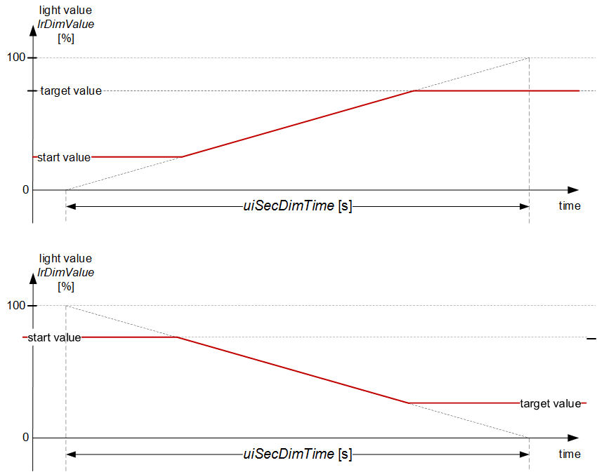

The light output value lrDimValue always follows the target values specified to it via a ramp. As in the case of the user function FB_BARLightCircuitDim, this is defined by a ramp time – in this case uiSecDimTime – which indicates the time interval in seconds that the light output value should require in order to change by 100%.

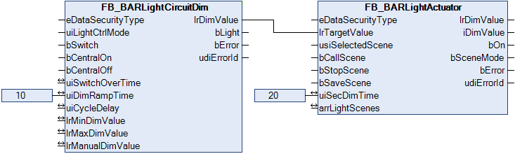

Example 1:
In this constellation the function block FB_BARLightCircuitDim will change its output value lrDimValue from 0% to 100% in 10 s. However, the function block FB_BARLightActuator can follow these continuously changing setpoint values only with a ramp time of 20 s (related to a change from 0% to 100%). Therefore this is ultimately the resulting ramp time.

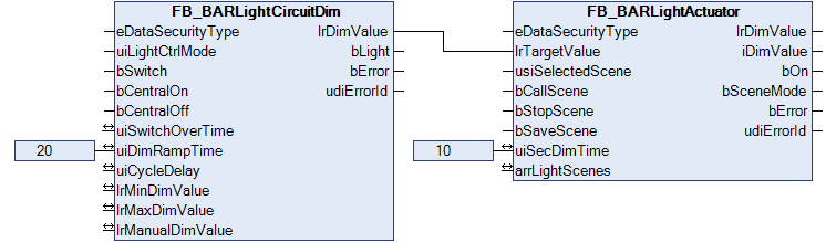

Example 2:
Conversely the function block FB_BARLightActuator could follow much faster here with a ramp time of 10 s. However, since the dimming function block FB_BARLightCircuitDim presets its setpoints in this example only with a ramp time of 20 s, this longer time is also relevant in this case.
It must be noted in this example that a short button press on the function block FB_BARLightCircuitDim immediately changes the output lrDimValue to the internally-saved value (see FB_BARLightCircuitDim). Hence, the ramp time on the FB_BARLightActuator is then relevant.

uiSecDimTime: Ramp time in seconds. This is the time that the light actuator function requires in order to regulate from 0..100%.
