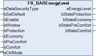

FB_BAREnergyLevel
This function block is for the adaptation of the supply of energy for the use of the building. The type of room utilization is set by the BMS. The longer a building or room is not used, the further the energy level can be lowered. The energy level currently selected by the function block is transferred to the room temperature controller.

eDataSecurityType : E_HVACDataSecurityType;
bSetDefault : BOOL;
bEnable : BOOL;
bWindow : BOOL;
bProtection : BOOL;
bEconomy : BOOL;
bPreComfort : BOOL;
bComfort : BOOL;

bEnable: The function block is activated by a TRUE at this input.
bWindow: The window contact is connected to this input. TRUE means that the window is OPEN. FALSE means that the window is CLOSED.
bProtection: Protection mode is activated with the input bProtection. Protection mode is active if the input is TRUE.
bEconomy: Economy mode is activated with the input bEconomy. Economy mode is active if the input is TRUE.
bPreComfort: The Pre-comfort level is activated with this input. The Pre-comfort level is active if the input is TRUE.
bComfort: The Comfort level is activated with this input if the room is occupied.
eEnergyLevel : E_BAREnergyLevel;
bStateProtection : BOOL;
bStateEconomy : BOOL;
bStatePreComfort : BOOL;
bStateComfort : BOOL;
eEnergyLevel: This output contains the current energy level (see E_BAREnergyLevel).
bStateProtection: The state of the bProtection input is relayed to the outside in the operation modes eBAREnergyLevel_AUTO_I and eBAREnergyLevel_AUTO_II.
bStateEconomy: The state of the bEconomy input is relayed to the outside in the operation modes eBAREnergyLevel_AUTO_I and eBAREnergyLevel_AUTO_II.
bStatePreComfort: The state of the bPreComfort input is relayed to the outside in the operation modes eBAREnergyLevel_AUTO_I and eBAREnergyLevel_AUTO_II.
bStateComfort: The state of the bComfort input is relayed to the outside in the operation modes eBAREnergyLevel_AUTO_I and eBAREnergyLevel_AUTO_II.
eCtrlMode : E_BAREnergyLevel;
eCtrlMode: Using this ENUM the operation mode can be preselected from the building management level (see E_BAREnergyLevel). The variable is saved persistently. Preset to automatic.
