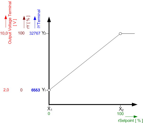

Application example:
Damper actuator working range 2 to 10 V with the KL4404 (signal voltage 0 to 10 V)
rX1 = 0 / iY1 = 6553
rX2 = 100 / iY2 = 32767

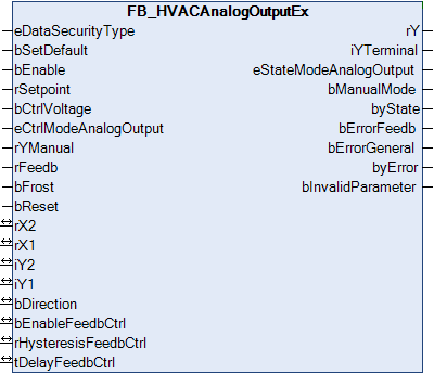

FB_HVACAnalogOutputEx/FB_HVACAnalogOutputEx2 2:
eDataSecurityType    : E_HVACDataSecurityType;
bSetDefault          : BOOL;
bEnable              : BOOL;
rSetpoint            : REAL;
bCtrlVoltage         : BOOL;
eCtrlModeAnalogOutput: E_HVACAnalogOutputMode;
rYManual             : REAL;
rFeedb               : REAL;
bFrost               : BOOL;
bReset               : BOOL;

rY                     : REAL;
iYTerminal             : INT;
eStateModeAnalogOutput : E_HVACAnalogOutputMode;
bManualMode            : BOOL;
byState                : BYTE;
bErrorFeedb            : BOOL;
bErrorGeneral          : BOOL;
byError                : BYTE;
bInvalidParameter      : BOOL;

rX2                   : REAL;
rX1                   : REAL;
iY2                   : INT;
iY1                   : INT;
bDirection            : BOOL;
bEnableFeedbCtrl      : BOOL;
rHysteresisFeedbCtrl  : REAL;
tDelayFeedbCtrl       : TIME;
rX2: Upper limit value on the X-axis (-32767..32767). The variable is saved persistently.
rX1: Lower limit value on the X-axis (-32767..32767). The variable is saved persistently.
rY2: Upper limit value on the Y-axis (0..32767). The variable is saved persistently.
rY1: Lower limit value on the Y-axis (0..32767). The variable is saved persistently.
bDirection: The output signal of rY is inverted by the variable bDirection. FALSE corresponds to the direct control direction. The variable is saved persistently.
bEnableFeedbCtrl: Analog actuators often have positional feedback. The function of the actuator is monitored by means of the positional feedback. Positional feedback monitoring is activated if the variable bEnableFeedbCtrl is TRUE. The variable is saved persistently.
rHysteresisFeedbCtrl: Due to the stroke time of typical drives used in heating and air conditioning systems, the positional feedback always lags in the case of a jump in the set position value. Using the variable rHysteresisFeedbCtrl, a range is specified within which the position setpoint rY of the actuator may deviate from the feedback signal (0..32767). The variable is saved persistently.
tDelayFeedbCtrl: If the difference between the set position and the actual position of the actuator is greater than +/- rHysteresisFeedbCtrl, then the response of the output bErrorFeedb is delayed by the time of the timer tDelayFeedbCtrl (0s..50s). The variable is saved persistently.
