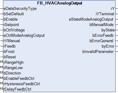

This function block serves to control analog actuators, such as valves or dampers, with positional feedback.
eDataSecurityType     : E_HVACDataSecurityType;
bSetDefault           : BOOL;
bEnable               : BOOL;
rSetpoint             : REAL;
bCtrlVoltage          : BOOL;
eCtrlModeAnalogOutput : E_HVACAnalogOutputMode;
rYManual              : REAL;
rFeedb                : REAL;
bFrost                : BOOL;
bReset                : BOOL;
Notice
bEnable: The function block is enabled if bEnable = TRUE. If the function block is not enabled the value zero is output at the output rY.
rSetpoint: The setpoint for the analog output is transferred to the function block with the variable rSetpoint.
bCtrlVoltage: The control voltage is present if the bCtrlVoltage variable is TRUE. The feedback control is deactivated in the event of failure of the control voltage so that no false alarms occur.
eCtrlModeAnalogOutput: Enum that defines the operation mode (see E_HVACAnalogOutputMode).
TYPE E_HVACAnalogOutputMode :
eHVACAnalogOutputMode_Auto_BMS := 0,
eHVACAnalogOutputMode_Manual_BMS := 1,
eHVACAnalogOutputMode_Auto_OP := 2,
eHVACAnalogOutputMode_Manual_OP := 3
END_TYPE
rYManual: Analog input value, which is relayed to the output rY in manual mode.
rFeedb: Analog positional feedback from the actuator.
bFrost: This input serves to protect an air heater against frost. As soon as the input bFrost is TRUE, rY is set to the maximum size (rRangeHigh) and iYTerminal to 32767. The outputs rY and iYTerminal remain set until the input bFrost is once again FALSE.
bReset: Acknowledge input in the event of a fault.
rY                        : REAL;
iYTerminal                : INT;
eStateModeAnalogOutput    : E_HVACAnalogOutputMode;
bManualMode               : BOOL;
byState                   : BYTE;
bErrorFeedb               : BOOL;
bErrorGeneral             : BOOL;
byError                   : BYTE;
bInvalidParameter         : BOOL;
rY: Shows the current magnitude of the control signal in % (0%..100%).
iYTerminal: Represents the size of the output signal scaled to the value range 0 to 32767.
eStateModeAnalogOutput: Enum that indicates the operation mode (see E_HVACAnalogOutputMode).
bManualMode: The analog output is in manual operation mode.
byState: Status byte indicating the operating state of the function block.
byState.0
:= bEnable;
byState.1 := bManualMode;
byState.2 := bFrost;
byState.7 := bCtrlVoltage;
bErrorFeedb: Error feedback signal.
bErrorGeneral: This is a collective message for all function block errors.
byError: Delivers all error messages and warnings.
byError.1 := bInvalidParameter
byError.2 := bErrorGeneral
byError.3 := bErrorFeedb
bInvalidParameter: TRUE if an error has occurred during the plausibility check. The message must be acknowledged with bReset.
rRangeHigh            : REAL;
rRangeLow             : REAL;
bDirection            : BOOL;
bEnableFeedbCtrl      : BOOL;
rHysteresisFeedbCtrl  : REAL;
tDelayFeedbCtrl       : TIME;
rRangeHigh/rRangeLow: These two variables define the value range of rY (0%..100%). The variable is saved persistently.
Example: rSetpoint = 100, rRangeLow = 0, rRangeHigh = 200,
==> rY = 50
==> rYTerminal = 16384
rSetpoint = 200, rRangeLow = 0, rRangeHigh = 200,
==> rY = 100
==> rYTerminal = 32767
bDirection: The output signal of rY is inverted by the variable bDirection. FALSE corresponds to the direct control direction. The variable is saved persistently.
bEnableFeedbCtrl: Analog actuators often have positional feedback. The function of the actuator is monitored by means of the positional feedback. Positional feedback monitoring is activated if the variable bEnableFeedbCtrl is TRUE. The variable is saved persistently.
rHysteresisFeedbCtrl: Due to the stroke time of typical drives used in heating and air conditioning systems, the positional feedback always lags in the case of a jump in the set position value. Using the variable rHysteresisFeedbCtrl, a range is specified within which the position setpoint rY of the actuator may deviate from the feedback signal (0..32767). The variable is saved persistently.
tDelayFeedbCtrl: If the difference between the set position and the actual position of the actuator is greater than +/- rHysteresisFeedbCtrl, then the response of the output bErrorFeedb is delayed by the time of the timer tDelayFeedbCtrl [s] (0s..50s). The variable is saved persistently.
