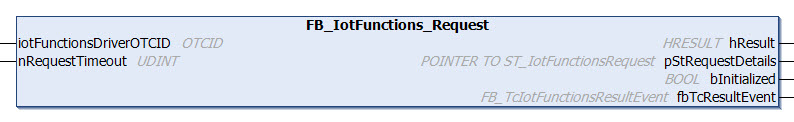

FB_IotFunctions_Request
FB_IotFunctions_Request 1:
The function block enables the synchronization of multiple messages (see Synchronizing message operations).
Syntax
FUNCTION_BLOCK FB_IotFunctions_Request
    iotFunctionsDriverOTCID : OTCID;
    nRequestTimeout         : UDINT;
    hResult             : HRESULT;
    pStRequestDetails   : POINTER TO ST_IotFunctionsRequest;
    bInitialized        : BOOL;
    fbTcResultEvent     : FB_TcIotFunctionsResultEvent;
