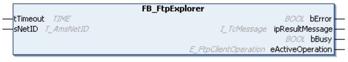

This function block can be used to perform file and directory operations, e.g. creating new directories on the FTP server or reading existing directories. The corresponding operations are available as methods on the function block.
Inputs
tTimeout : TIME;
sNetID : T_AmsNetID;
tTimeout | TIME | Indicates the ADS timeout to be used between PLC runtime and the FTP client user mode process (in seconds). |
sNetID | T_AmsNetID | AmsNetID of the device on which the FTP client user mode process is running. Normally, the FTP client and the PLC run on the same system, so no value needs to be assigned to this variable. |
Outputs
bError : BOOL;
bBusy : BOOL;
eActiveOperation : E_FtpClientOperation;
bError | BOOL | TRUE if an error has occurred. |
ipResultMessage | I_TcMessage | Output with extended error and diagnostic information based on the TwinCAT 3 EventLogger. |
bBusy | BOOL | TRUE as soon as the function block is in use. |
eActiveOperation | Indicates the current transfer operation. |
