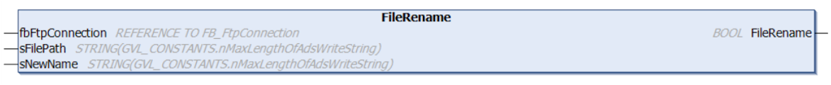

FileRename
FileRename 1:
Renames a file on the server.
Syntax
METHOD FileRename : BOOL
    fbFtpConnection : REFERENCE TO FB_FtpConnection;
    sFilePath       : STRING;
    sNewName        : STRING;
FileRename 2: Return value
Type
FileRename
Returns TRUE when the method has completed. Whether the action was successful can be read from the bError variable of the function block.
FileRename 3: Inputs
Type
fbFtpConnection
FB_FtpConnection
References the server connection to be used for the operation.
sFilePath
STRING
Path to the file on the server.
sNewName
STRING
New filename.
