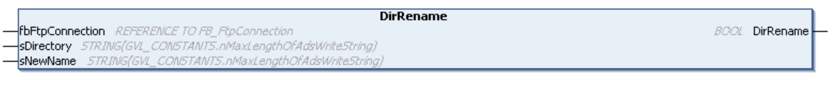

DirRename
DirRename 1:
Renames an existing directory on the server.
Syntax
METHOD DirRename : BOOL
    fbFtpConnection : REFERENCE TO FB_FtpConnection;
    sDirectory      : STRING;
    sNewName        : STRING;
DirRename 2: Return value
Type
DirRename
Returns TRUE when the method has completed. Whether the action was successful can be read from the bError variable of the function block.
DirRename 3: Inputs
Type
fbFtpConnection
FB_FtpConnection
References the server connection to be used for the operation.
sDirectory
STRING
Path to the directory to be renamed.
sNewName
STRING
New directory name.
