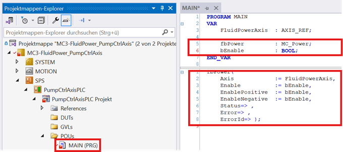

- 1. Double-click on MAIN and create an instance of Tc3_Mc3Ptp.MC_Power;
see MC_Power - 2. Implementation of a cyclic call to the created instance
FluidPowerAxis : AXIS_REF;
fbPower : MC_Power;
bEnable : BOOL;
END_VARfbPower(
Axis := FluidPowerAxis,
Enable := bEnable,
EnablePositive := bEnable,
EnableNegative := bEnable,
Status=> ,
Error=> ,
ErrorId=> );Absolute positioning

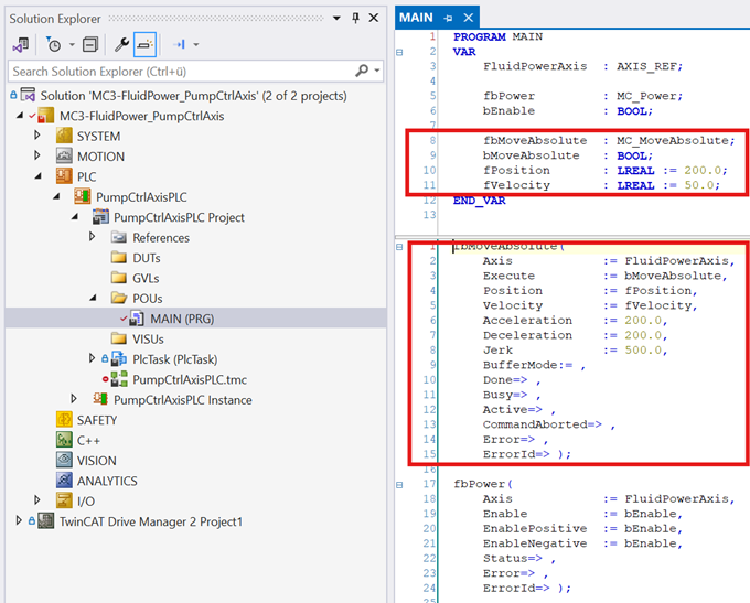

- 3. Creating an instance of Tc3_Mc3Ptp.MC_MoveAbsolute;
see MC_MoveAbsolute - 4. Implementation of a cyclic call to the created instance
→ The axis can now be powered using the PLC and moved to its end position.
fbMoveAbsolute : MC_MoveAbsolute;
bMoveAbsolute : BOOL;
fPosition : LREAL := 200.0;
fVelocity : LREAL := 50.0;fbMoveAbsolute(
Execute := bMoveAbsolute,
Position := fPosition,
Velocity := fVelocity,
Acceleration := 200.0,
Deceleration := 200.0,
Jerk := 500.0,
BufferMode:= ,
Done=> ,
Busy=> ,
Active=> ,
CommandAborted=> ,
Error=> ,

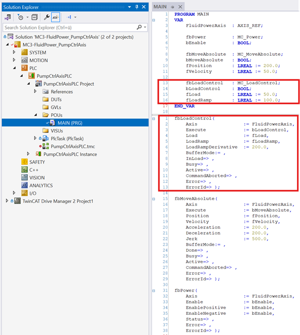

ErrorId=> );Pressure/force control
- 5. To create an instance of Tc3_Mc3Ptp.MC_LoadControl,
see MC_LoadControl - 6. Implementation of a cyclic call to the created instance
→ The pressure/force control of the axis can now be triggered via the PLC.
fbLoadControl : MC_LoadControl;
bLoadControl : BOOL;
fLoad : LREAL := 50.0;
fLoadRamp : LREAL := 100.0;fbLoadControl(
Execute := bLoadControl,
Load := fLoad,
LoadRamp := fLoadRamp,
LoadRampDerivative := 200.0,
BufferMode:= ,
InLoad=> ,
Busy=> ,
Active=> ,
CommandAborted=> ,
Error=> ,
ErrorId=> );The next step is to optimize the pressure controller;
