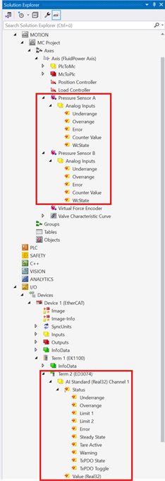

- The hardware configuration has been created.
- Pressure sensor A/B has been created.
Procedure: Example for EL307x, ED307x
- 1. Select the link you want to link to.
- 2. Right-click on Change Link…
- 3. Select the hardware link you want to link.
- 4. Confirm the selection with the OK button.
