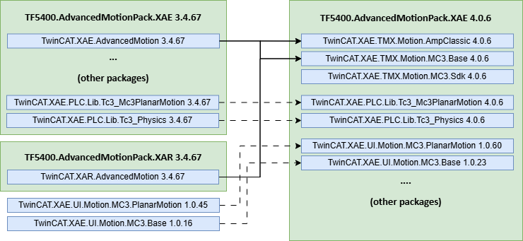

Installation
Update the TF5400.AdvancedMotionPack.XAE workload to version 4.0.12 or higher. The following image shows the changes to the workloads and packages. If you need version 4.0.6, you must install the packages shown in the image individually, since the workload is not available until version 4.0.12.

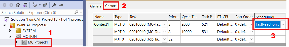

Project Settings in the Motion Node
In the MC Project, the new "Scheduling" setting in the Context tab must be set to "Fast Reaction" instead of "Stable"; otherwise, an error message regarding the Planar objects will appear at startup, see “Scheduling”.
1. Select the MOTION > MC Project node ( 1).
2. Go to the Context tab ( 2).
All contexts and objects of the MC Project are listed there.
3. In the Scheduling column, set the value for the context of the Planar objects toFast Response (3).

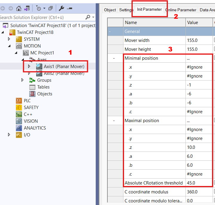

Mover Object Settings in the Motion Node
In the mover objects, the new parameters “Minimum/Maximum Position” and “Absolute CRotation threshold” must be checked. These must be compatible with the hardware being used and the desired application; see mover/Configuration/InitParameter, starting with version V4.0.6.
4. Select the node MOTION > MC Project1 > Axes > Axis1 (Planar mover) (1).
5. Go to the Init Parameter tab ( 2).
All of the Planar Mover's initialization parameters are listed there.
6. For the new parameters, enter the values appropriate for the Planar mover in the Value column (3).
