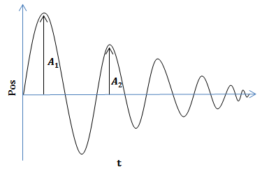

P-AXIS-00568 | Damping factor of natural frequency | |
Description | Besides the natural frequency itself, this parameter can also specify the damping factor of the natural frequency which is defined as follows:
Parameter | vib_guard.damping | |
Data type | REAL64 | |
Data range | 0 ≤ damping ≤ 1 | |
Axis types | T, R, S | |
Dimension | T: ---- | R,S: ---- |
Default value | 0.1 | |
Drive types | ---- | |
Remarks | The parameter is available as of V3.1.3075.00 | |
