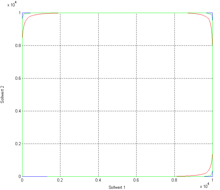

Programming Example
Program 90° corners – with and without tolerance monitoring
The contour is traversed 3 times:
- with Vibration Guard and tolerance monitoring.
- with only Vibration Guard and
- finally without Vibration Guard activated as reference.
