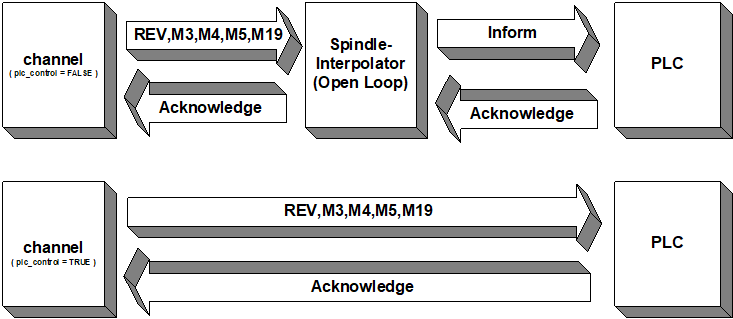

P-CHAN-00069
Spindle control by PLC via channel specific interface
This parameter is set to TRUE if a spindle is controlled directly by the PLC and not by a spindle interpolator in the NC channel. Note here that all synchronisations are no longer (spindle) axis-specific but are output and processed by the channel-specific HLI range. The axis-specific syntax for programming spindle commands is still allowed, but is limited to specifying the speed and the M functions M3/M4/M5/M19.
Parameter
spindel[i].plc_control
Data type
BOOLEAN
Data range
0/1
Dimension
Default value
0
Remarks
Description 1:

Parameterisation example: The process time of the spindle function is defined as 1 s for an ‘S1’ spindle.
spindel[0].bezeichnung     S1
spindel[0].log_achs_nr      6
spindel[0].s_prozess_zeit      1000000
spindel[0].m3_prozess_zeit     1000000
spindel[0].m4_prozess_zeit     1000000
spindel[0].m5_prozess_zeit     1500000
spindel[0].m19_prozess_zeit    2000000
