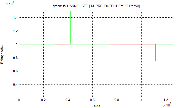

Programming Example
Explicit feed programming for MicroJoints

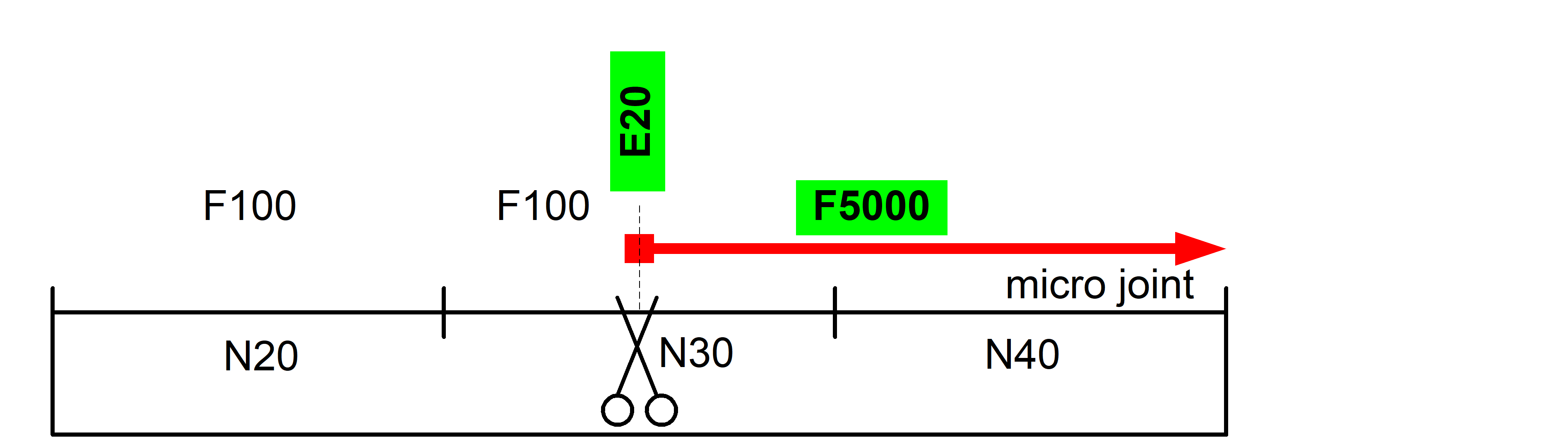

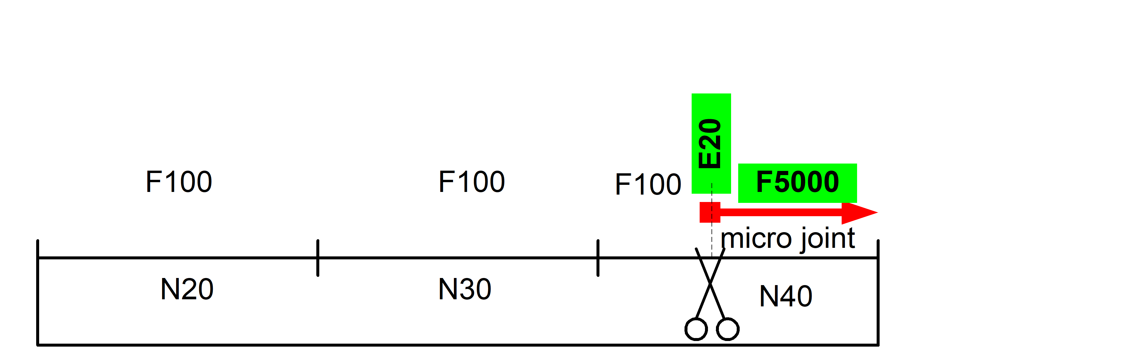

MicroJoint feed across multiple blocks
When the pre-output of the M function is advanced across multiple blocks, the feed of all MicroJoint motion blocks is also changed to the specified value.
A possibly explicitly programmed feed is replaced by the specific MicroJoint feed.
Programming Example
![]() | Specifying a MicroJoint specific feed replaces the possible explicitly programmed feed of the NC block. See example above: F7500 in N40 is replaced by F5000. |

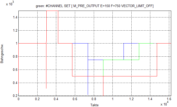

Suppress VECTOR_LIMIT during MicroJoint
