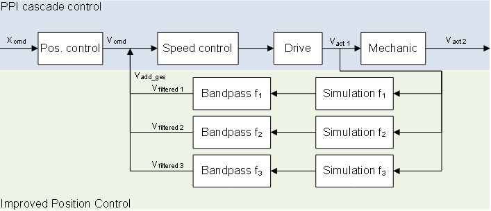

"INDIRECT" mode (P-AXIS-00753) can be used if the measuring system does not include the vibration to be damped (P-AXIS-00751). The mechanical vibration is simulated by a digital filter:
"INDIRECT" mode 1:
Extending the cascade rule for "INDIRECT" mode
The filer cascade is identical to the “DIRECT” mode.
A simulation of the mechanical vibration can be executed by specifying a separate damping ratio (P-AXIS-00850) for each of the frequencies to be damped. The simulation results are handled in the same way as the results from measurements taken by a direct measuring system in “DIRECT” mode..
The simulated frequency spectrum is reduced by a suitable band-pass filter to the appropriate frequency in each case. Optionally, the phase length of the filtered speed can be adapted by parameterising an all-pass filter.
Finally, the results of the individual filter paths are added.
After scaling the resulting speed, an additional additive speed (vIPC) is added to the manipulated variable of the position controller (vCmd) This causes the motor to actively counteract the vibration in each case.
