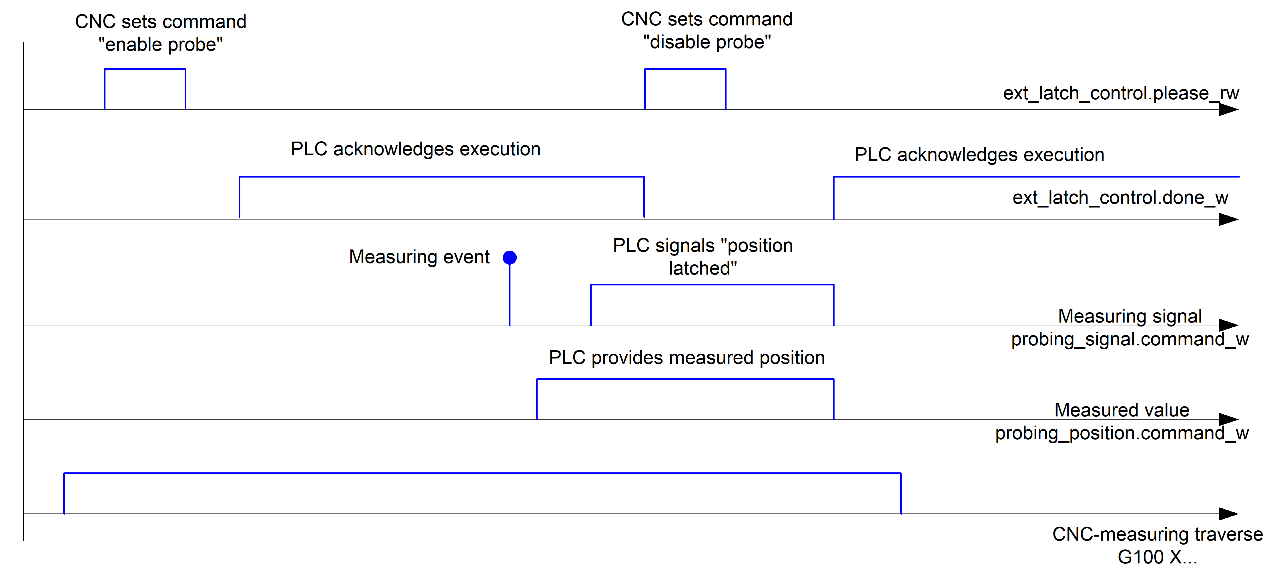

Signal profile with PLC_EXT_LATCH_CTRL
The block diagram below shows an example of the signal profile of the control units ext_latch_control, probing_signal and probing_position during a measurement process with external hardware:
Signal profile with EXT_PROBE_WITH_DRIVE
The block diagram below shows an example of a measurement process using switchable external hardware:
