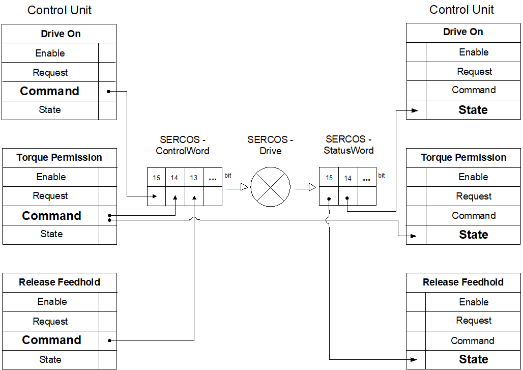

The diagram below shows the relationship between HLI control units and the SERCOS control word or the SERCOS status word for SERCOS drives.
Axis control commands 1:
Interaction of control units and SERCOS control or status words
