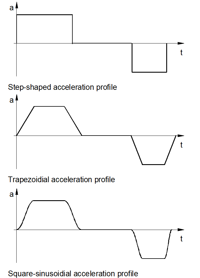

Acceleration profiles
Selecting the acceleration profile defines the velocity on the programmed path, provided
The following modes are available :
Depending on the acceleration profile selected, the acceleration is set as shown in the acceleration profile below:
Acceleration profiles 1:
Path acceleration profiles
The NC controller calculates the path distance to be output in the current cycle for the programmed path based on distance data, velocity inputs in the NC program and the dynamic variables of the machine axes.
Planning the resulting velocity profile extends over several blocks and ensures that stopping is possible at all times without overshooting the permissible dynamic limits (look ahead).
